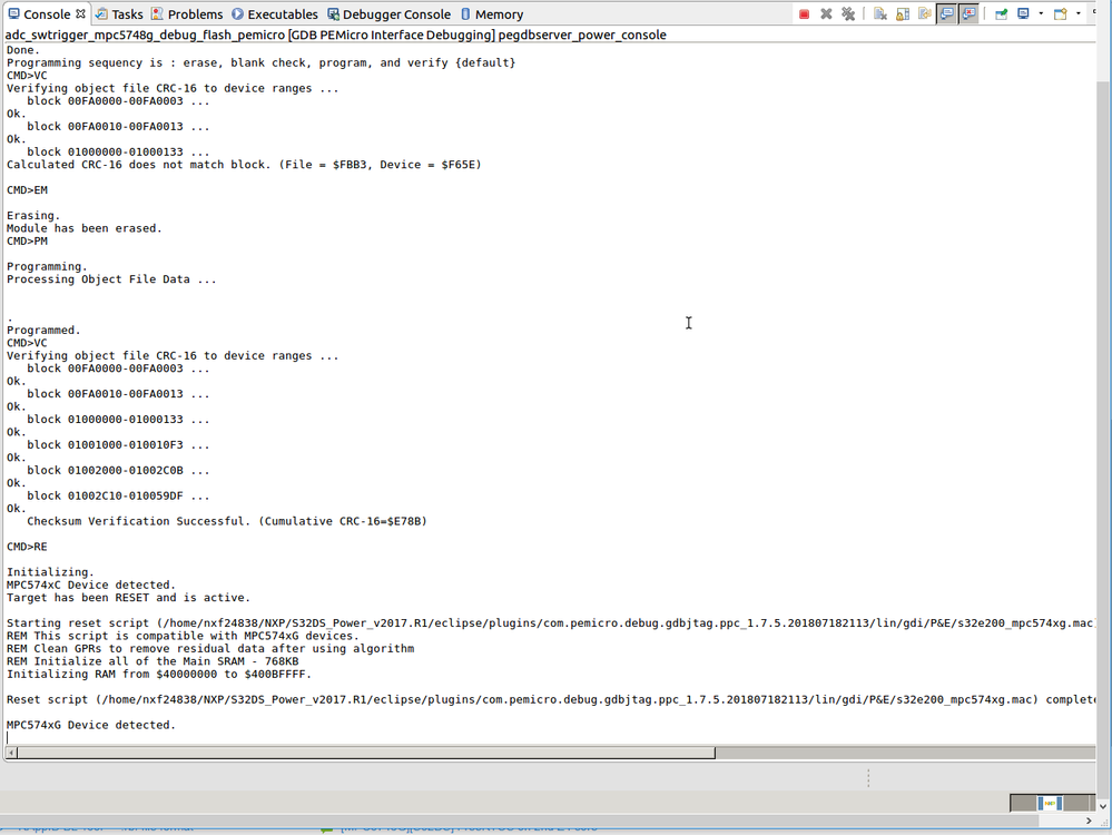

it looks that you are using old version of PE Micro plugin - 1.7.2 . Current version is 1.7.5. Here is output from my console:

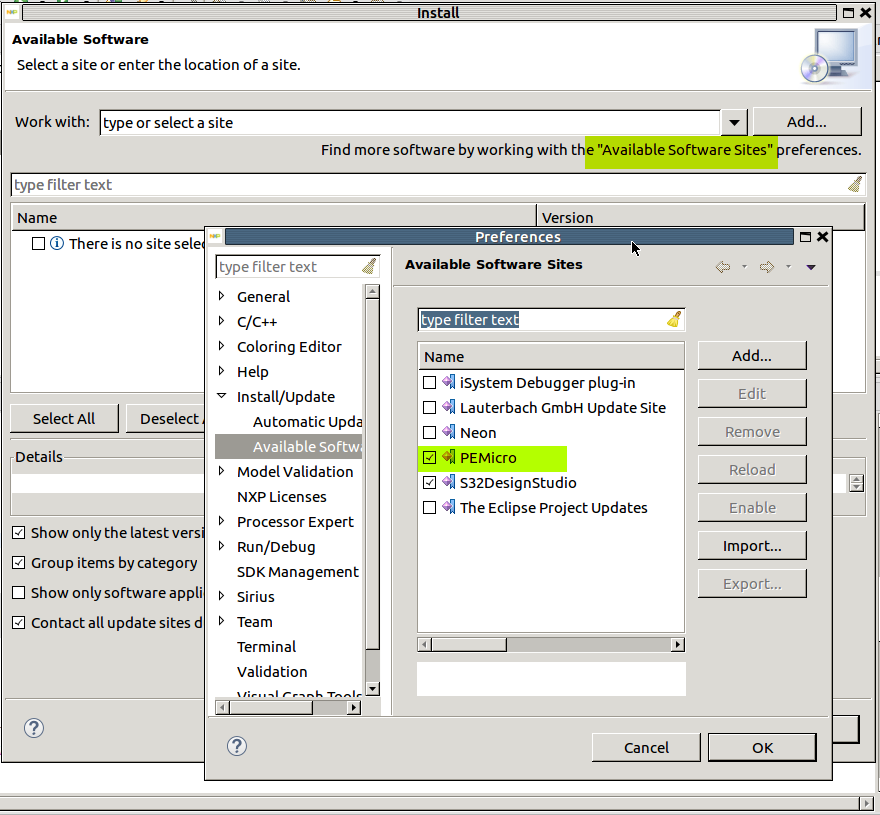

Try to update your S32DS - Click on Help -> Install new Software. Click on Available Software Sites and make sure that PE Micro is enabled:

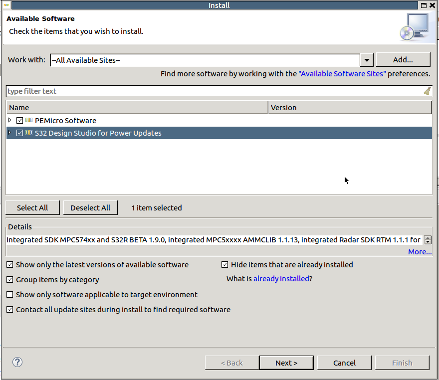

Select All Available Sites in Work with combo box and continue with update.

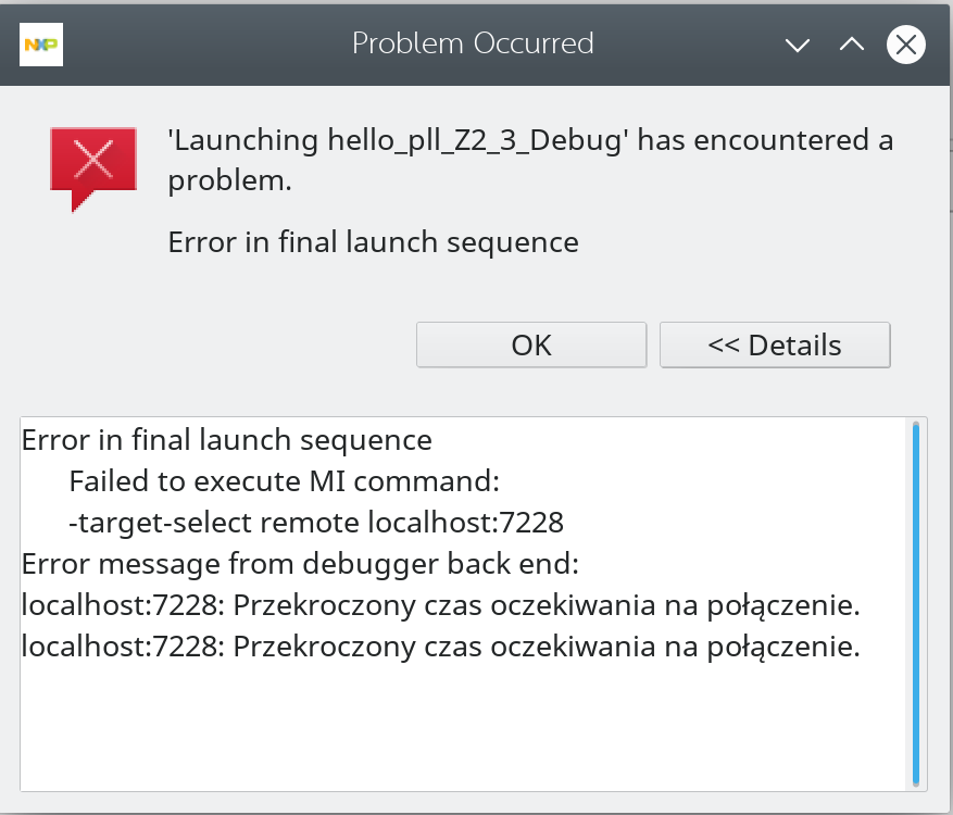

I have done above update procedure step by step with success, Unfortunately flashing behavior doesn't changed - still hanging. I attached screenshot i receive after some time ( where: Przekroczony czas oczekiwania na polaczenie = Connection timeout ). It looks everything is clear but I don't know why i get this while i have clear installation - there is no info related to additional steps needed for eg. gdb server configuration or something.

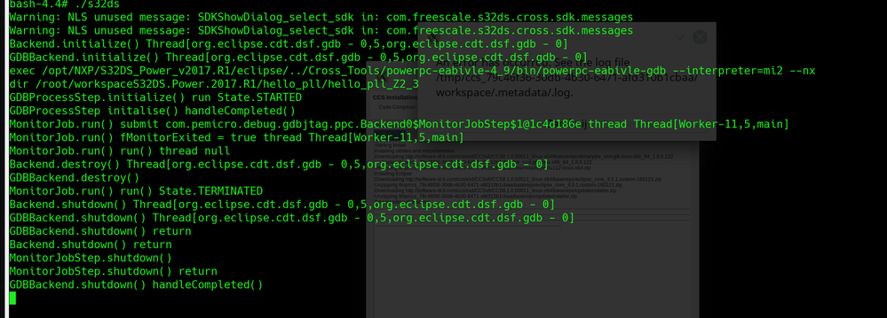

Below snapshot from console :

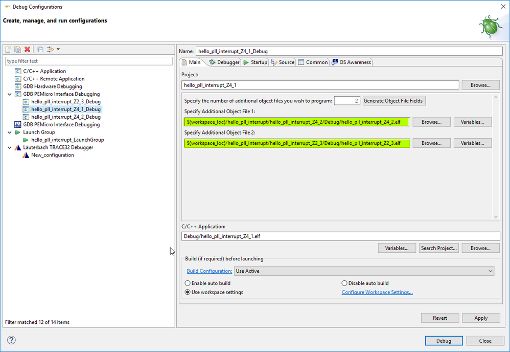

I found reason but i'm not sure why it is like that,
I use DEVKIT-MPC5748G, which is equipped with 3 core MCU :  Z2_3 ,Z4_1,Z4_2.
Assuming I have 3 separate core application ( hello example ) - i can flash just when i have selected first core Z4_1 - Then I'm able select appropriate debug interface OpenSDA in flash windows ( Debug tab). When I try to do this for other core - flashing suck in one place (90%).
Similar situation is when i'm going to connect for debug - i can just debug core Z4_1, but while i try to debug other cores - debugger is going to hang on 90% as described above.
It seems S32DS can debug just first core - or there should be additional settings to perform debug on other cores.
I have the same situation is on WIN and on LINUX so it is common issue. I'll try dig into documentation but I anyone have idea what to do in that matter i'll be very appreciated.

jiri_kral

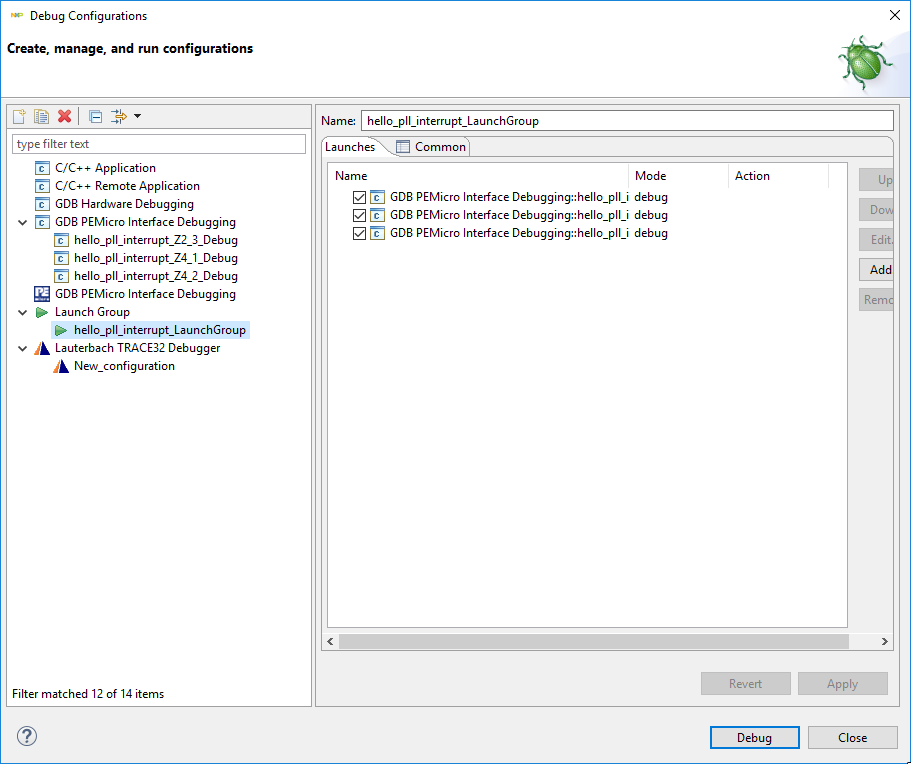

the Z4_1 is boot core and is starting other cores. There is no way how to use this MCU without Z4_1 running (uploading .elf for that core).
You can start debug with Z4_1 core - this config uploads also additional elf for other cores:
Or  you can use launch group:
