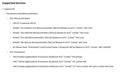

Hi @fjiewjg
MQX only supports Kinetis, iMX.RT and iMX. It doesn't support other products. See below link
https://www.nxp.com/design/design-center/software/embedded-software/mqx-software-solutions/mqx-v5-so...
Hope this helps,
Jun Zhang
