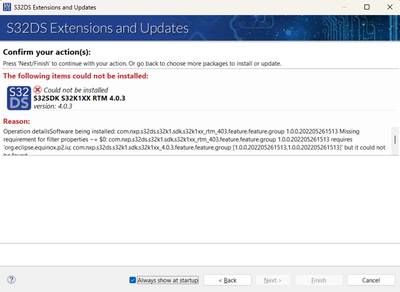

Anilpatil_SasvaAuto
Unable to install, getting error
3,305 Views
Robin_Shen
Please show me a screenshot of the error.
Some companies' IT restricts http access, Did you change Available S32DS Software Sites to https

Anilpatil_SasvaAuto
Please find the error details as attached

Robin_Shen
Please check if the S32K1xx development package has been installed?
If not, please install the S32K1xx development package first. Refer to:
 S32 Design Studio 3.4 S32K1xx Service Pack 1 (SW32K1_S32DS_3.4.1_D2106.zip)

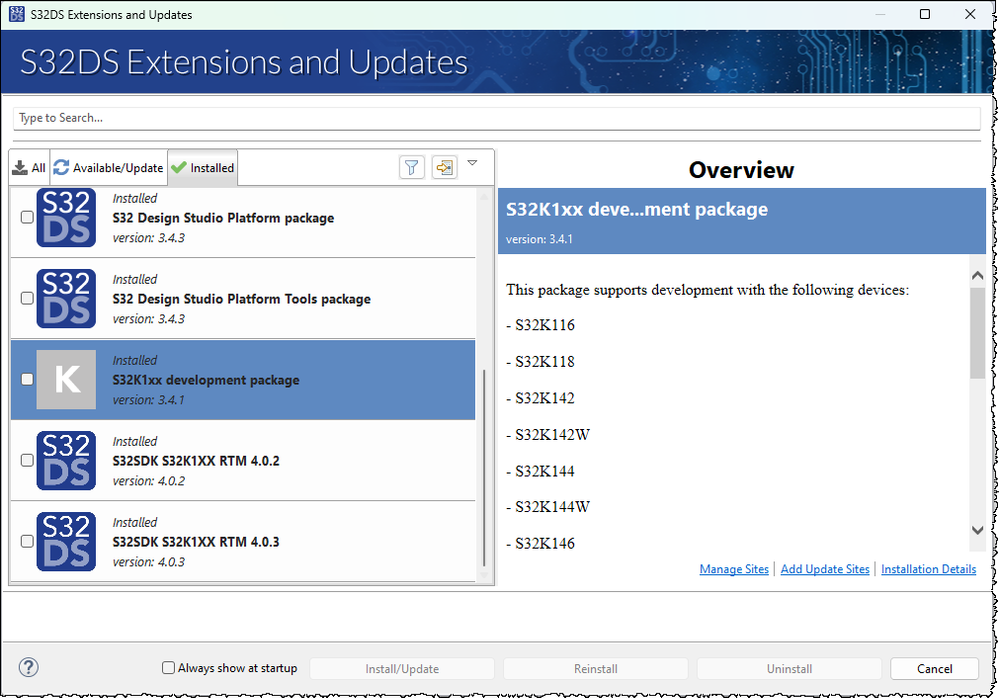

Did you install S32K1xx development package by refer to https://community.nxp.com/t5/S32K/Trying-to-install-the-S32SDK-S32K1xx-RTM-4-0-2-SDK-extension/td-p/... ?
After you have installed SW32K1_S32DS_3.4.1_D2106.zip offline, you should be able to install S32SDK S32K1XX RTM 4.0.3 online via S32DS Extensions and Updates.
2,919 Views
Anilpatil_SasvaAuto
Thanks, installed successfully
