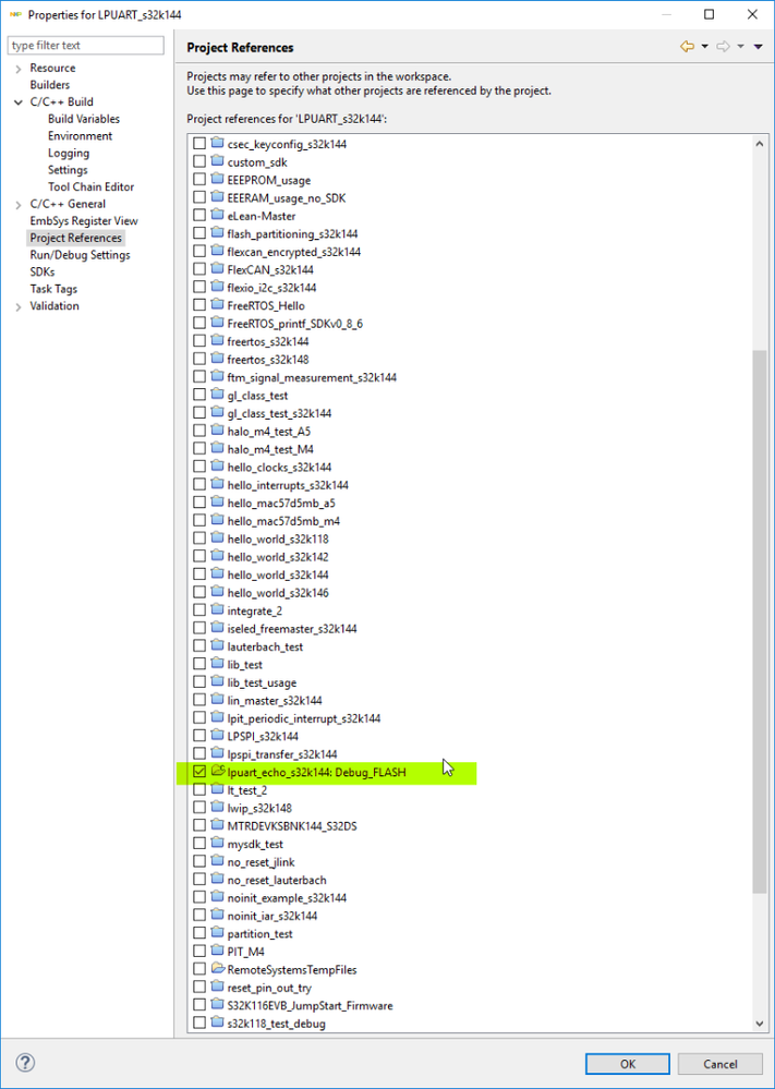

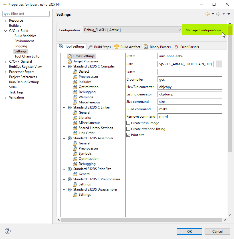

unfortunately S32 Design studio doesn't support new project inside another project. You can use two solutions. First one - add new build configuration into existing project and specify different output target (but you need to switch between configurations manually):
Second option is add new project into workspace and set dependency on your first project or projects. In this case - all dependent project will be build together:
In my example case - the LPUART_s32k144 project depends on lpuart_echo_s32k144 project and each time when I'll build LPUART_s32k144 the lpuart_echo_s32k144 project will be build as well.
