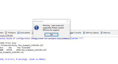

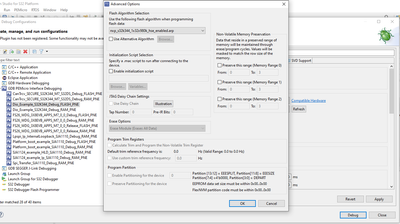

I am working with S32K344 T172 EVB, and I accidentally issued the flash memory of the device.
Now, when I try to flash my binary to the board via S32 Design Studio IDE, I receive the message:

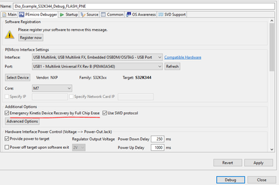

I also tried to enable Full chip erase, but then it said that the Mass erase not support
Can anyone please help me to resolve this issue so that I can re-flash my board? Thanks

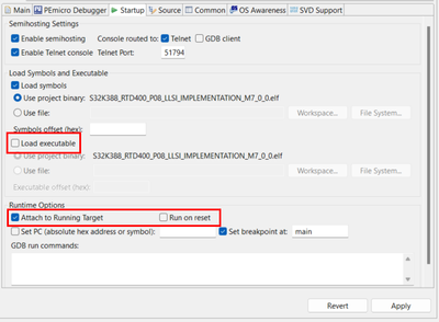

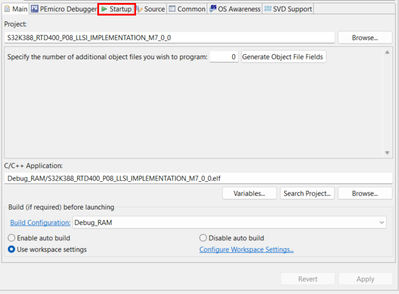

In the debug configurations go to the Startup tab
and select the following:

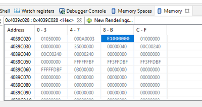

With this, instead of loading the executable, it will simply be attached to the microcontroller, and with this, you can try to pause to see in which memory address it was running. If it is at address 0x20400100 or similar, it means that it is in recovery mode.
Additionally, if you manage to pause the microphone, you could share an image of memory address 0x4039C028 to see the HSE GPR.
6,595件の閲覧回数

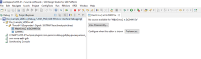

quangvuanh
Hi @VaneB
I follow your guideline, then the program pause here -> seem that your assumption is correct
And the value stored at 0x4039C028
6,575件の閲覧回数
VaneB
Hi @quangvuanh
It seems that the device is currently going into recovery mode.

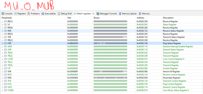

Can you please look for the registers FSR and GSR of the MU_B? That may help us identify if there is anything wrong occurring with the initialization of the HSE FW.
B.R.
VaneB
6,488件の閲覧回数
quangvuanh
@VaneB , Here are the registers ' values
6,469件の閲覧回数
VaneB
Hi @quangvuanh
What was the last thing you uploaded to your device? How did you do it? Also, what type of HSE FW does your device have? Do you have a standard one or is premium one?

VaneB
Hi @quangvuanh
S32K3 devices do not support mass erase as shown in the last shared image.
Are you using HSE FULL MEM or AB SWAP? It looks like you are using the wrong program.
