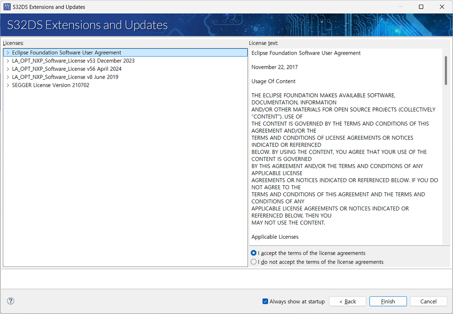

Hello.

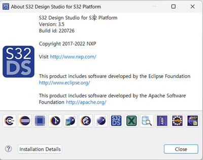

Step 1. I install S32DS for S32 v3.5.
- Install program: S32DS.3.5_b220726_win32.x86_64.exe

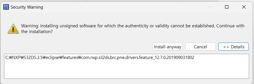

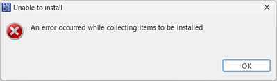

Step 2. Select "S32 Design Studio Platform package" and execute update.

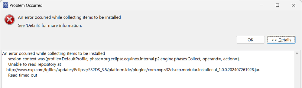

Step 3. After few minute update failed with "Read time out" error.
Step 4. Close & Restart S32DS, and retry update "S32 Design Studio Platform package".
Step 5. S32DS program close suddenly. And s32ds.exe, s32ds.bat file deteled.
I attached my step screen capture below.
How can I clean install S32DS for S32 v3.5 and update latest package?

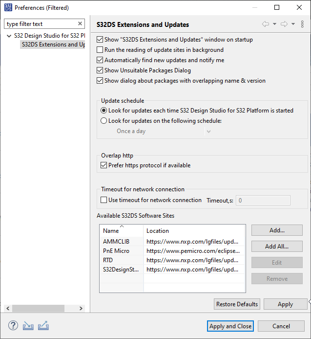

jiri_kral
on some machines doesn't work repositories with http:// - please try to change http:// to https://

ssean
Thank you for support!
It works.

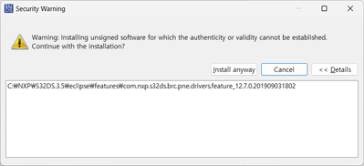

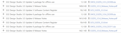

I already tried offline update.
Update okay with belows.
SW32_S32DS_3.5.2_D2302, SW32_S32DS_3.5.3_D2306, SW32_S32DS_3.5.4_D2307, SW32_S32DS_3.5.5_D2308, SW32_S32DS_3.5.6_D2309.
When I try update to SW32_S32DS_3.5.8_D2311, warning message popup.
I choose "Install anyway", after then program close (without any message), and deleted s32ds.exe and s32ds.bat.
When I try update to latest package SW32K3_S32DS_3.5.13_D2407 at one-shot(without update previous version), same issue happend.
And.. I can't find offline update package for Update 7.
Could you check for me?
Sean Sung.

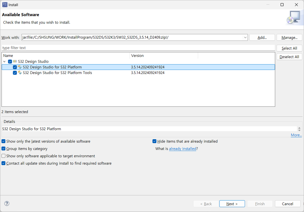

ssean
Hi @Robin_Shen
When I try offline update to SW32_S32DS_3.5.14_D2409, same issue (deleted .exe, .bat files) happened.
SW32K3_S32DS_3.5.13_D2407.zip is my mistype, I don't need that.
Seam Sung.
