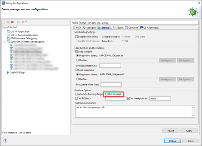

    I am currently using the MPC5744P with S32 Design Studio (S32DS) version 2.1. I created a project using "Project from Example" and when I try to debug and flash the program, I encounter the error "No source available for '0x1000000'". Moreover, this address is not within the MAIN program. What additional settings might be needed? Thank you.

Hi @lukaszadrapa,
I tried to uncheck "Run on reset," but I still can't get breakpoints to stop in main.c. The breakpoints always stop at 00000010: se_illegal. Any ideas on what might be causing this? tanks.

Hi @ted_cys
According to your screenshot, machine check exception was triggered after reset and before reaching main function. I would try to uncheck "Run on reset" like this in Debug configurations:
Then the program will stop directly on entry point after loading and you can debug/step also the startup files to see what's wrong.
