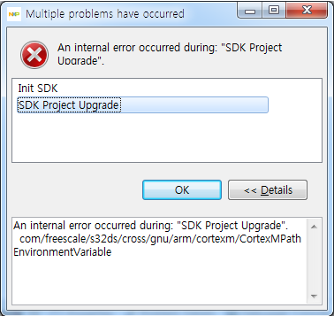

However, Problems will occur when installing S32DS_ARM_v2018.R1_UP*.zip.(update 1,8,9,10)

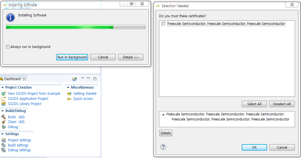

Whenever i perform an update, the 'freescale semiconductor' message appears.
If i select ok, an error will occur in S32DS.
If i select cancel, it can not update.

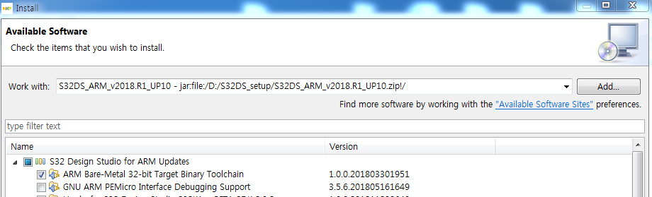

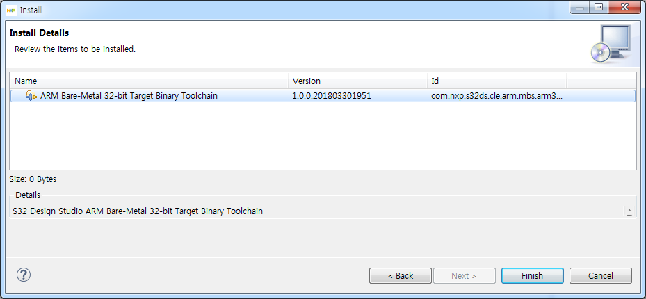

1) offline installation
- Help" -> "Install New Software..." -> S32DS_ARM_v2018.R1_UP10
2) install start
3) 'freescale semiconductor' message appears.
4) If it select cancel
