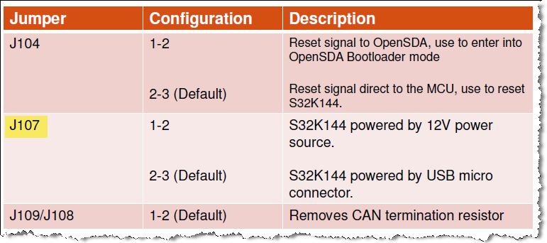

Hi wei,
Please check the jumper setting of J107. If connect 1-2, then you need to power S32K144 by external 12V power source.

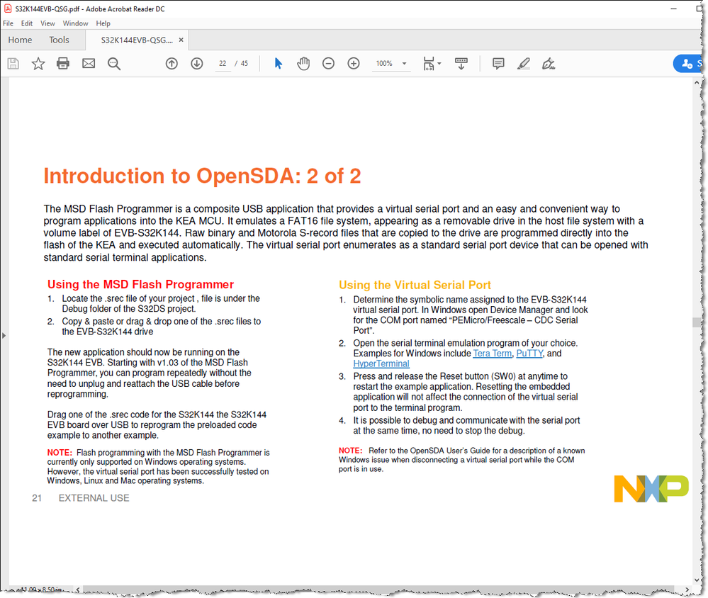

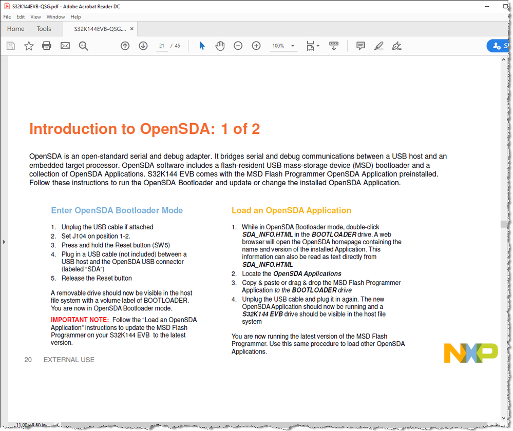

Have you try to use the on board debug interface? The OpenSDA should be able to debug S32K144 by default.
