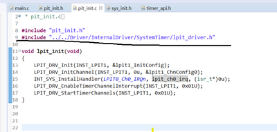

Hello EveryOne, How to configure the S32DS IDE, then you can directly import the header file without writing the file path address? thanks

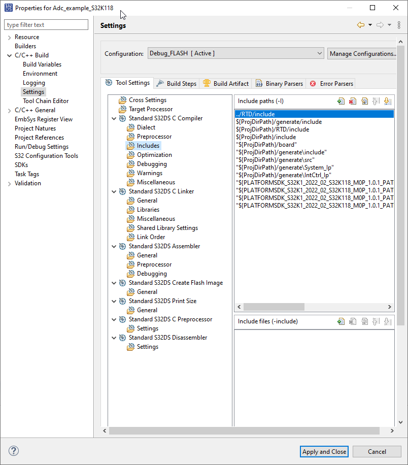

you can add  include path in Project Properties:
Jiri
