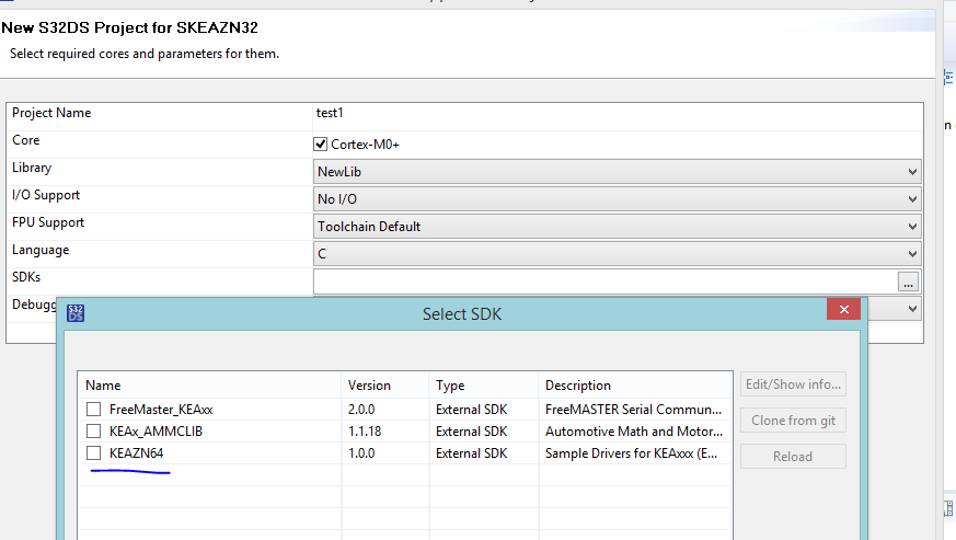

Do we need to select SDKs while creating project?
SDK for FRDM-KEAZN32Q64 are not available.
By default it is showing below options. Which one to choose?
8,342 Views
stanish
You don't have to select SDK.

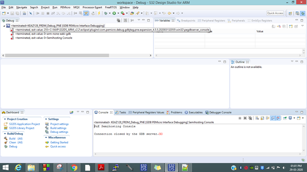

aashitole
Now, I can see the USB port.
However getting these errors when I try to load the code/ program the board.
