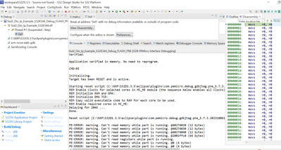

hello,
I got a issue when I debug  with S32DS .
I use PE to debug S32K344 mini EVB ,
The board and PE is OK ,I can debug with IAR IDE normally;

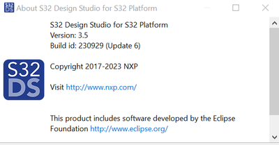

S32DS version:
I flashed the code (both demo code or myself code), it run to the main,
when I Step into or Step over , it showed like this
I tried to re-install the S32DS ,but the issue still exist.
how can I solved this issue?
Thank you very much.
All console  information:

PE-ERROR: Warning. Can't read memory while part is running. @40274040 (12 bytes)
PE-ERROR: Warning. Can't read memory while part is running. @400f00 (64 bytes)
PE-ERROR: Warning. Can't read memory while part is running. @400f38 (2 bytes)
PE-ERROR: Warning. Can't read memory while part is running. @400f24 (2 bytes)
PE-ERROR: Warning. Can't read memory while part is running. @400f14 (2 bytes)
PE-ERROR: Warning. Can't read registers while part is running.
4,248 Views
KidhRobin
thank you ,this issue had been solved.
I closed the memory related window, it can work normally.
Maybe once before I used these function in a project ,but I do not close these windows ,then when I debug another project ,this error happened;
I found that even if I delete all the project and then create a new one, I still encounter the same error. Reinstalling S32DS doesn't help either; only after closing these windows, can I work normally.

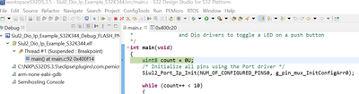

Anu_123
Hi ,
I'm also face same issue.
While I'm flashing the Clock_Ip_Example_S32K344 and Mcu_Example_S32K344 code.
The Clock_Ip_Example_S32K344 code flashes with no issue. But Mcu_Example_S32K344 shows some error during the flash such as,
  1. PE-ERROR: Warning. Can't read registers while part is running
  2. PE-ERROR: Warning. Can't read memory while part is running
Due to these error, that code does not execute the MCU_SetMode(McuModeSettingConf_0); function.
I closed the memory related windows, still I faced same issue.
3,547 Views
juan_see
Hi @Anu_123 ,
I ran a quick test on my S32K3X4EVB-T172 and did not see the "PE-ERROR: Warning. Can't read registers while part is running" that you described.
I was able to reach the "if (Mcu_GetClockFrequency(CLKOUT_RUN_CLK) != CLOCKOUT_FREQ_CFG_0)" line.
Can you please try closing the "0x0" file that is open in your view and try launching a debug session again:
