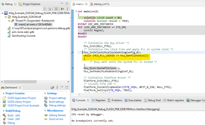

I tried to be flashing the example code of Watchdog timer from S32K3XX AUTOSAR 4.4-R21-11 RTD 3.0.0 D2303 Example Project in S32 Design Studio for S32 platform 3.5. Whenever after flash and run the code its stuck into DELAY loop of startup_cm7.s file after the PLL while loop is called.
Below I attached the image. How can we recover from this loop and how can we successfully run the watchdog timer code.

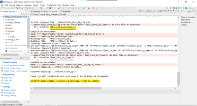

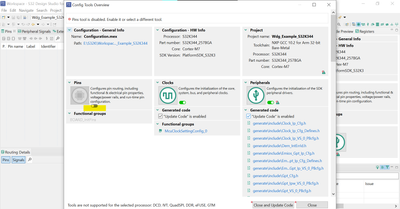

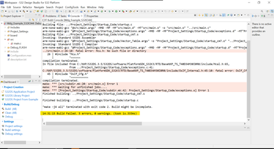

Initially, it showed errors during the build. So, I made some changes to fix those errors, such as:
  1. I enabled the PIN option.

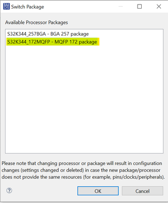

  2. I switched the package to the S32K344_172MQFP 172 package.

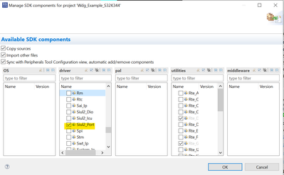

After these changes, I generated the code again, but it showed some errors. So, I enabled the driver such as Siul2_Port.
I only made the above-mentioned changes. Again, I generated the code and it was error-free. Then I flashing the code, it got stuck in the loop I previously mentioned.

I made the mentioned modifications and the code works as expected. if you have a custom board, please make sure that your clock configurations are correctly set.
