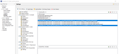

Hi.
Could you tell me how to change the route to absolute reference?

Hi, @shin000 ,
Very sorry for replying very late, were able to work forward.
You can click on the option as shown in the image with + mark, and add file path.
Thank you. Best regards.
