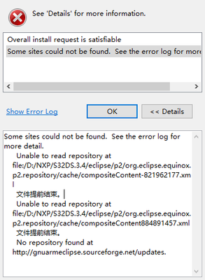

Hello:
我在安装S32DS v3.4以及RTM4.0.3时遇到了一些问题,如附件中所示,报错了,我不知道是为什么,之前在其他电脑上安装的时候,没有发生这个问题,希望能得到解答

From the screenshot I cannot identify RTM package or which device you are you are trying to install.
Anyway as a general suggestion I'd first install the generic packages such as "S32 Design Studio platform" and "S32 Design Studio tools platform", debugger/PEMCO packages/updates and then restart S32DS and proceed to Development packages for the device you are using. Finally, I'd install the SDK package dedicated to your device family or specific device.

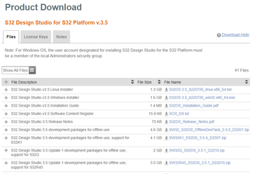

FYI: there is newer version of S32DS v3.5 (update 13) already available so if you are starting your project development it could be better to switch to latest version.

Sorry for the late response. My previous project was created using S32DS 3.4 based on the S32_SDK_S32K1xx_RTM_4.0.3 extension package. After downloading S32DS 3.5, I am unable to open the project correctly. When I try to download S32DS 3.4 on a new computer, I get an error message. Could you please help me resolve this issue?

The updater errors seem to be related to a non-available update site.
Are you able to proceed to project build even with the errors you posted?
