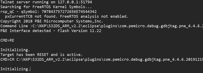

As of the end of last week. Nobody is able to successfully debug using S32DS for ARM or Platform. It is able to compile the project, but debugging is not working. If no errors occur, then the console is stuck as shown in the image below. Sometimes there is a runtime error. I checked two machines, and neither have had any recent updates. The behavior started last Thursday or Friday. This is debugging with PE Micro Multilink universal. Any ideas on what could be the issue?

It looks like we narrowed this down to SentinelOne, and anti-virus package. Disabling this fixed everyone's issues.
