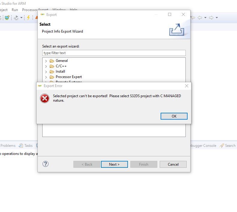

Hello all,
I want to export my example project to .xml file so i can import it to IAR embedded workbench. There is procedure given in nxp community how to do it. I am following same method but i am getting this error.
Please let me know how to resolve this error while exporting project.
Thank you,

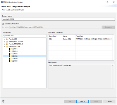

Seems you are trying to export probably a generic Eclipse project.

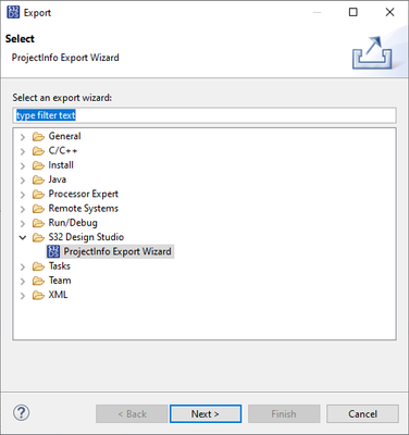

The project exporter works for S32 Application project.
Could you please create a new S32DS Application project and select IAR toolchain:
and try to export it into xml file again?
Hope it helps.
