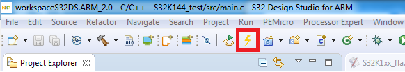

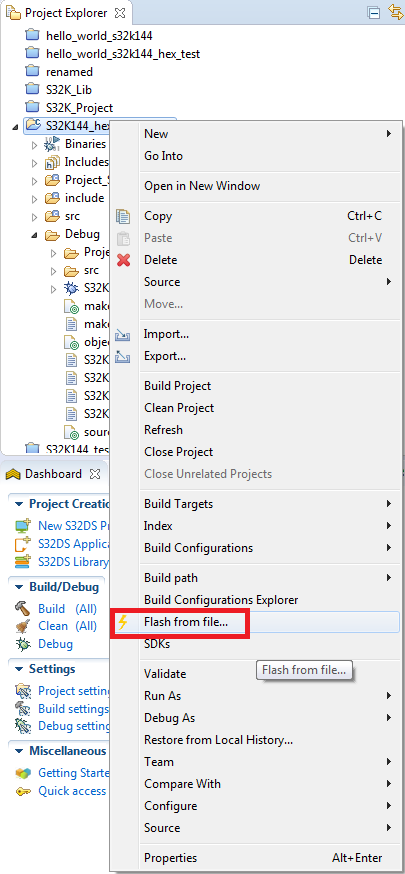

If you want to program multiple binary/elf files using P&E/OpenSDA interface you can benefit from "Flash from File" feature:
or
You can create a new Flash configuration from scratch or clone an existing one. Then you can basically add any number of additional files you need to program and browse for any of elf/srec/intel hex.
You can recognize verification of the multiple address ranges in the GDB Server PEmicro Console.

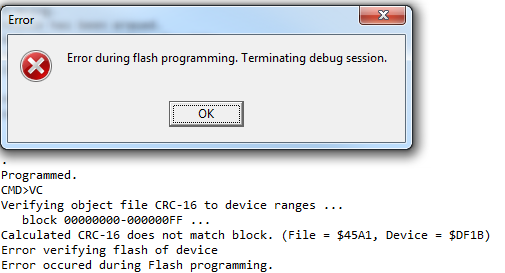

Please make sure the binary/elf files do not overlap each other otherwise programming ends up with an error below:
