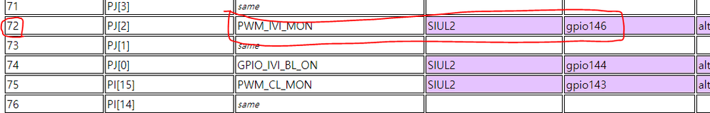

My development environment is
IDE : S32DS Power 2.1 + SDK 3.0.3
Target MCU : SPC5748G 176pin
I assigned some GPIO using PE then generate and download
But I saw something weird

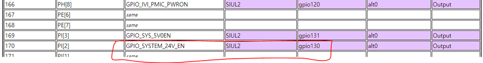

I set toggle GPIO146(PJ[2], Pin 72) but it comes from pin 146
I could find the problem information at pin setting component generate report HTML > Pin assignment
The assignment table shows GPIO number instead of Pin number and working as actual pin.

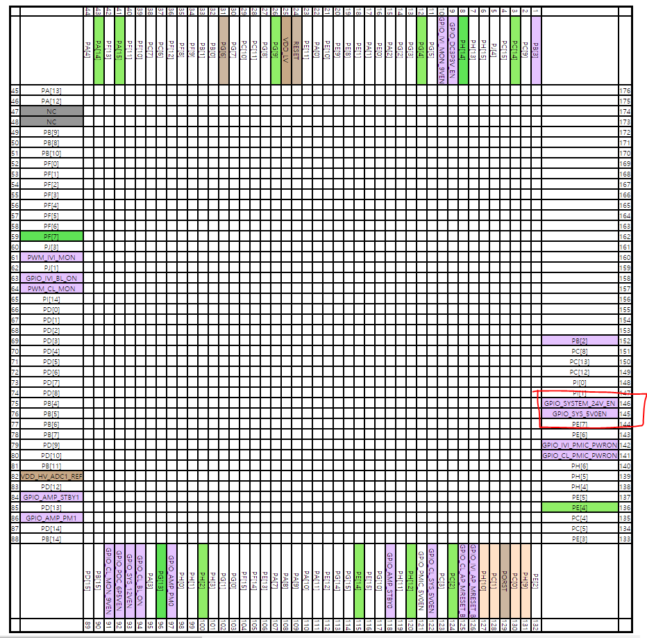

Here's HTML Report( wrong?? )
Pin Assignment HTML ReportPin Assignment HTML Report
Routed Pins in pinsetting HTML report ( Correct information )
Thank you.

thanks for report. I can reproduce your issue. It looks, that the Package layout has incorrectly assigned pin numbers to port names. In your case the Pin number 72 is in package layout shown as a pin 61 - PWM_IVI_MON  I'll create bug ticket. This issue has not effect on program itself - it is related to HTML report only.
