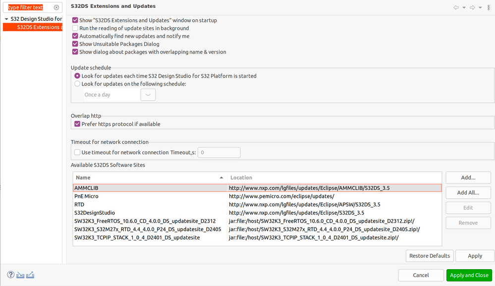

I am trying to install several update sites in Design Studio 3.5, following the instructions from this page. Running on Ubuntu 20.04, Design Studio build ID 240726 (update 13).
Steps I'm following:
  1. Download the update sites (zip files).
  2. In DS, go to Help -> S32DS Extensions and Updates
  3. Click Add Update Sites, select downloaded zip files
  4. Design Studio shows a progress bar. There is no error message or any other information
  5. At this point, I expect the packages I added to show up in the list of available updates, but they do not
  6. Restarting Design Studio doesn't help, removing and re-adding the update sites doesn't help
These are the update sites I'm trying to add:
  • SW32K3_FreeRTOS_10.6.0_CD_4.0.0_DS_updatesite_D2312.zip
  • SW32K3_S32M27x_RTD_4.4_4.0.0_P24_DS_updatesite_D2405.zip
  • SW32K3_TCPIP_STACK_1_0_4_D2401_DS_updatesite.zip
Here's a screenshot of the available S32DS software sites in my install. So the sites were added, the packages from them just don't show up.
Can anyone help?
