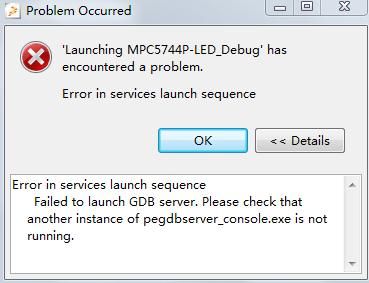

Iam using PE micro multilink USB universal FX JTAG cable for debugging/Flashing the Code to microcontroller(MPC5744).
When I debug, there is something wrong likes that:

I  found  the questions :my  workspace path has Chinese characters.
