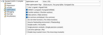

hi, everyone
When I used PE to debug burning, I encountered an error message from p&e semihosting console.
Please refer to the picture below and solve my problem. I need your help very much! Thank you
Connection from "127.0.0.1" via 127.0.0.1. Connection from port "61351" to 6224
Connection from "127.0.0.1" via 127.0.0.1. Connection from port "61428" to 7224
Telnet server running on 127.0.0.1:51794
Searching for Kernel Symbols...
rsp_qC - qSymbol: 5F74785F7468726561645F63757272656E745F707472
  _tx_thread_current_ptr not found. ThreadX analysis not enabled.
rsp_qC - qSymbol: 707843757272656E74544342
  pxCurrentTCB not found. FreeRTOS analysis not enabled.
Unable to load libusb0.dll
Copyright 2024 P&E Microcomputer Systems,Inc.
Command Line :C:\NXP\S32DS.3.5\eclipse\plugins\com.pemicro.debug.gdbjtag.pne_5.9.2.202409131555\win32\pegdbserver_console -device=NXP_S32K1xx_S32K118F256M4 -startserver -singlesession -serverport=7224 -gdbmiport=6224 -interface=USBMULTILINK -speed=5000 -�
PEmicro Interface detected - Flash Version 11.37
CMD>RE
Initializing.
Target has been RESET and is active.
CMD>CM C:\NXP\S32DS.3.5\eclipse\plugins\com.pemicro.debug.gdbjtag.pne_5.9.2.202409131555\supportFiles_ARM\NXP\S32K1xx\freescale_s32k118f256m4_pflash_dflash_eeprom.arp
Initializing.
Initialized.
;version 1.02, 04/06/2020, Copyright 2020 P&E Microcomputer Systems, Inc. All rights reserved. www.pemicro.com [s32k118f256m4_x_pflash_dflash_eeprom_m0]
;device freescale, s32k118f256m4, pflash_dflash_eeprom
;begin_cs device=$00000000, length=$14000800, ram=$1FFFFC00
Loading programming algorithm ...
Done.
Programming sequency is : erase, blank check, program, and verify {default}
CMD>VC
Verifying object file CRC-16 to device ranges ...
   block 00000000-000000BF ...
Calculated CRC-16 does not match block. (File = $92D3, Device = $EDBA)
Current content of flash does not match application to be programmed
CMD>EM
Erasing.
Module has been erased.
Reloading programming algorithm ...
done.
CMD>PM
Programming.
Checking range of data.
Checked.
Processing Object File Data ...
Programmed.
CMD>VC
Ok.
   block 00000400-000084E7 ...
Ok.
   block 00038000-00038003 ...
Ok.
   block 00038010-00038013 ...
Ok.
   block 00038020-00038021 ...
Ok.
   block 00039000-0003900F ...
Ok.
   block 00039800-00039803 ...
Ok.
   block 0003A000-0003A01F ...
Ok.
   block 0003A800-0003A807 ...
Ok.
   block 0003B000-0003B01F ...
Ok.
   block 0003B800-0003B803 ...
Ok.
   block 0003C000-0003C00F ...
Ok.
   block 0003C800-0003C80D ...
Ok.
   block 0003D000-0003D001 ...
Ok.
   block 0003D800-0003D801 ...
Ok.
   block 0003E000-0003E003 ...
Ok.
   block 0003E800-0003E803 ...
Ok.
   block 0003F000-0003F001 ...
Ok.
   Checksum Verification Successful. (Cumulative CRC-16=$8855)
CMD>RE
Initializing.
Starting reset script (C:\NXP\S32DS.3.5\eclipse\plugins\com.pemicro.debug.gdbjtag.pne_5.9.2.202409131555\supportFiles_ARM\NXP\S32K1xx\S32K118F256M4.mac) ...
Filling .
 done
Reset script (C:\NXP\S32DS.3.5\eclipse\plugins\com.pemicro.debug.gdbjtag.pne_5.9.2.202409131555\supportFiles_ARM\NXP\S32K1xx\S32K118F256M4.mac) completed.
Disconnected from "127.0.0.1" via 127.0.0.1. Disconnection by port "61351" from 6224
Disconnected from "127.0.0.1" via 127.0.0.1. Disconnection by port "61428" from 7224
Target Disconnected.

Hi @Juns ,
PEmicro periodically updates the plugins on its website with new device support, new features, and bug fixes.
Please verify if the GNU ARM PEMicro Interface Debugging Support package requires an update.
You can see it in Help >> S32DS Extensions and Updates.
For more information on How to install and update PEmicro GDB Server plugin, please refer to the following link
PEmicro Blog: Install PEmicro’s GDB Server plugin in NXP’s S32 Design Studio for ARM to enable debug....
Hope it helps you.
