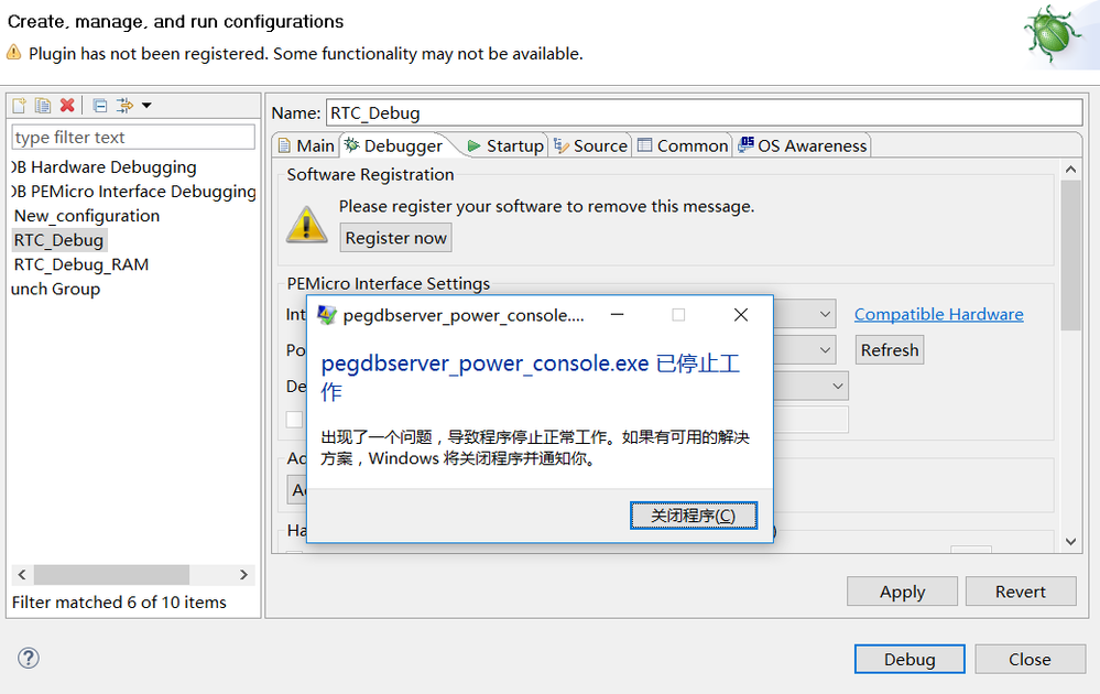

eautopower
There is a error,like:
I have already reloade  the S32DS ,but the problem remains unsolved.
please tell me what can I do?

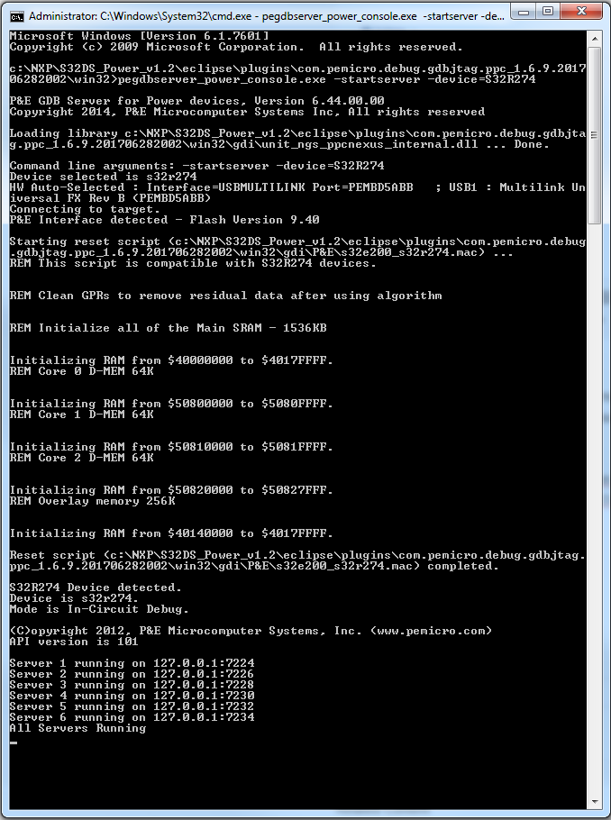

This is Pemicro GDB server crash. It seems there is an interference with another process. Could you possibly try to run GDB server in standalone mode. Let's assume you have S32R274 target.
Run GDB server:
<S32DS_Power_v1.2>\eclipse\plugins\com.pemicro.debug.gdbjtag.ppc_1.6.9.201706282002\win32\pegdbserver_power_console.exe -startserver -device=S32R274
you should observe something like this:
Are you able to start GDB server without IDE on your side?

eautopower
Incompatible with the WIN10 X64 system,it is ok now
