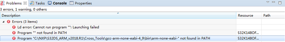

This problem occurs when I build my project.
why?

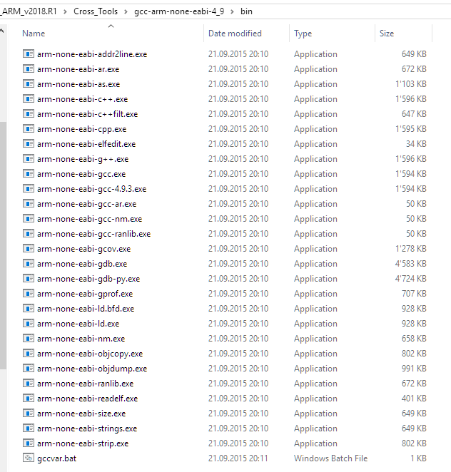

It seems that either your toolchain is not configured properly or that maybe a virus scanner has removed your binaries. Can you check that all the needed files are present in the bin folder?
Other than that, I recommend that you create a new project with the wizard and to see if the problem is with your project or with your setup. Or that you share/upload your project.

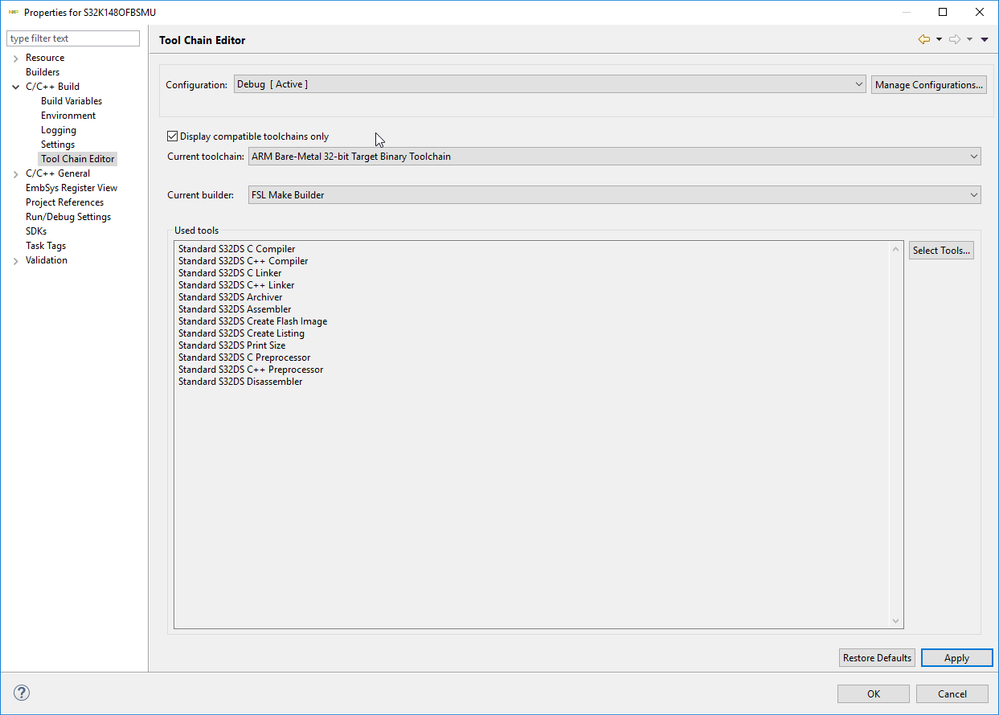

there was wrong toolchain in your project - just choose the correct one in project properties.
After that - GNU tools can be found.
