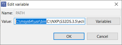

Thanks winsmen, this is the only workaround that solved the problem on my system.
This is a recurring issue I face with S32DS 3.5. In the past it seemed to eventually resolve itself after some time (perhaps Windows or antivirus policy updates), however on this occasion I had urgent work to do and I could not force it to function via system shutdown/restart or the autorebase.bat script.
Here is the exact procedure I used:
  1. Open project properties in S32DS.
    • Presently this needs to be done for all projects that are affected (which is anything built in S32DS managed make context).
  2. Expand C/C++ Build and select Environment.
  3. Select the PATH variable and click the Edit... button.
  4. Pre-pend the path to external directory (outside of S32DS installation) containing make.exe, for example I installed a separate instance of msys64 which includes make.exe at the default path of: C:\msys64\usr\bin.GaryRK_0-1701255227446.png
  5. Click OK then Apply and Close.
  6. Attempt to repeat the build or clean operation and it should now work.
I tried to apply this workaround at S32DS workspace level by defining the PATH variable in Window -> Preferences -> C/C++ -> Build -> Environment but this does not work. It only seems to support appending of environment variables to the project-local environment, meaning the non-functional S32DS make.exe will supersede the external instance and be invoked first leading to the error. I will update this thread if I find a way to apply the workaround in a general way.

winsmen
Posted this on the other thread linked earlier here too.
Managed to get rid of this error by using an externally installed copy of make in place of the one found within the NXP folder.
In the project Properties (File > Properties, or right click on project > Properties) expand C/C++ and go to Environment. Edit (or add) the PATH variable to include the path to the bin folder of your external Make installation at the beginning of the list. This bin folder would be the one containing the make.exe executable. Apply and Close. Rebuild.
