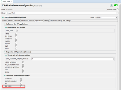

I am using the S32 Design studio for my project development on S32K148 chip.
I have created my project using S32SDK_S32K1XX_RTM_4.0.1 SDK package.
I need to use TLS based TCP-IP communication for my usecase, and hence looking to enable the wolfSSL middleware in my project, however, with the Manage SDK components and Peripheral View of Design Studio I am unable to find the option to enable this.
Please help me enable this library/middle-ware in the project.

take a look at lwip demo code and see Applications tab:

Thank you Lukas.
I am able to enable the wolfSSL in the project with the mentioned steps.
