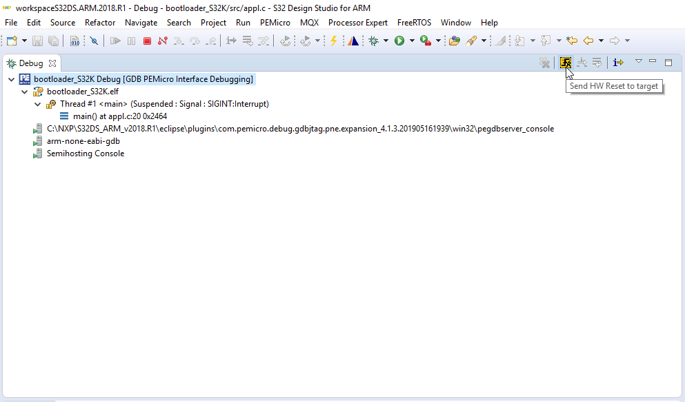

But I can't jump to Application function:
How can I solve it?I hope somebody has an idea.

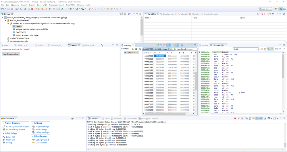

jiri_kral
can you please share more details? Are you using RappID bootloader, your custom bootloader, what kind of error/issue you can see?
Jiri
6,247 Views
jiri_kral
from your screenshot it looks that you already jumped into application, but application ends in some exception. Is your app running as standalone (without bootloader)?

Um, I don't get it. So, the first step is check, if the application is working without bootloader. It looks, that the issue is in the application itself, not in bootloader. If I'm correct - your app starts on 0xE000 - from screenshot you are already in the app - in loop on address 0xE46C. I'm assuming that this is loop where program ends if some exception occurs:

The issue may be caused by some peripheral already configured in Bootloader, clock settings, incorrect interrupt vector table (VTOR register - application vector table is on different location that boodloader's)  or any other stuff. It's hard to say where may be issue. Try to debug your code. Select your app project in design studio. In debug configuration choose attach to target, set breakpoint to app entry point:
invoke reset and step by step try find out what's wrong:
