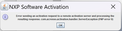

I cannot seem to get S32DS to activate the license. I have tried online (via local WiFi and mobile hotspot) to no avail (FNP error). I have tried the offline method through several other machines. Here's the error in the image below. I have attached the install log for reference.
Any ideas?
Thanks!

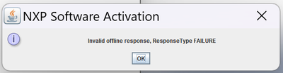

rmaier
Here's another offline attempt.

mikedoidge
Hello Robert,
As is noted in the release notes, the S32 Design Studio for Arm v2.2 is supporting the following versions of Windows OS:
We have not tested it for installation within Windows 11. I can see from the flexera activation server that the license request is not generated properly. This could be due to the version of FNP (FlexNet Publisher) which was included for the S32DS for Arm v2.2. It is likely this version does not work properly in Win11. I would suggest that you try to enable 'Windows 7 compatibility mode' on the install file and see if it will work. If this does not work, you will need to install Win10 or other supported version as listed in the release notes.

rmaier
Is there an update planned? New laptops are seldomly available with Windows 10.
I have tried everything imaginable. Nothing can get around the FNP issue. I think this is strictly an issue with the license manager. Perhaps a deactivated license? Or some temporary fix?
