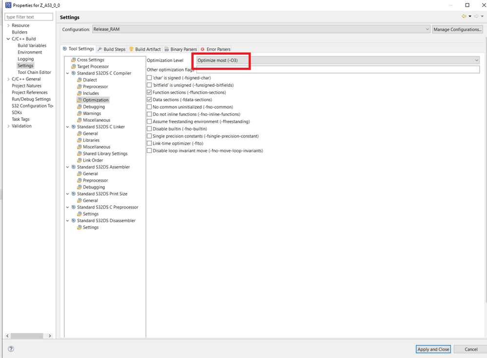

Hi, @Chad72 ,
Please can you check the the optimization level. If it is set to Optimize most -O3 level, that may cause the problem.
You can change the optimization by
Select the project name, then Right click -> build - > Properties -> C/C++ Build -> Settings -> Standard S32DS C Compiler -> Optimization ->
Then select
And change it to none
And, check if it works.
Thank you.
-Mehul Patel

Chad72
Hi Mehul,
thank you for your answer.
I have checked Optimization Level. It was already set to None by default. So it didn't change anything.
I still cannot find a way to set Building of the Project as Debug to Flash instead of Debug to RAM and when I recompile good working Debug Build into  Release Build, the program  just freezes after flashing the .elf file to MCU.
