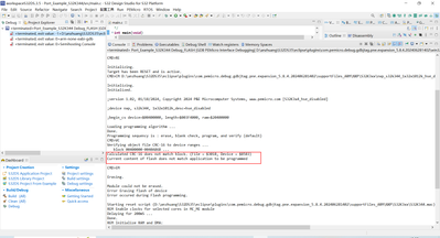

xuan
Debug An error occurs during debugging
I don't understand. What's the reason

Hi @xuan
This message does not represent an error, this means that the application you are trying to program is different from what the MCU previously had. If you flash a code (in this case Port_Example), then "Terminate" the debug session and flash the same code again without any modification you should see that the CRC match so the message does not appear.
