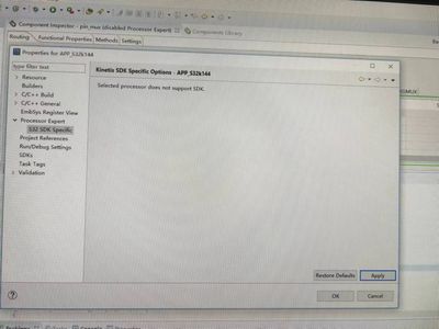

Hello Teams,
I found a very strange thing in the customer, I click the generate code, but it tells me that ProcessorExpert.pe is disabled, and my pins, peripherals, clock can not be configured, inside is gray
It also shows that the Selected processor does not support the SDK,The picture is attached.

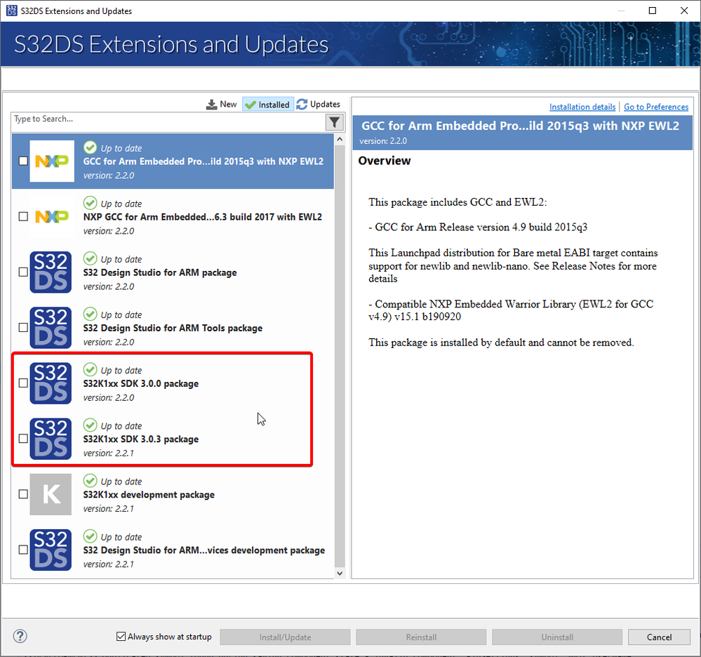

jiri_kral
do you have installed one of S32K1xx SDK (v3.0.0 or v3.0.3)?
8,796 Views
Zhuang
Of course, my version is SDK3.0.0, and I open routines in RTD as normal.

jiri_kral
can you please share screenshot with processor expert settings (Right click on project name -> Properties -> Processor Expert
8,827 Views
Zhuang
Hi  jiri_kral,
The attached picture is the interface where I opened Properties-Processor Expert, which shows the Selected processor does not support SDK
