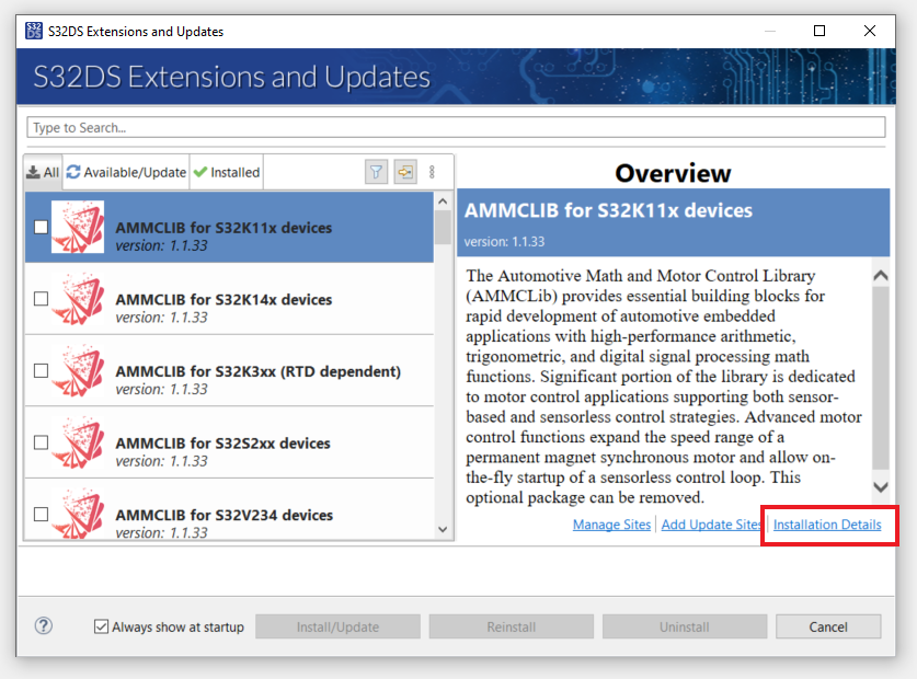

Hi, @cuongtran ,
Please can you provide the installation details, workspace log, and installation log.
1. Workspace log from the path
 C:\Users\Public\[workspace]\.metadata  (or wherever your relevant workspace is located).
2. Installation log from
C:\NXP\S32DS.3.5\_S32 Design Studio for S32 Platform 3.5_installation\Logs (or wherever your relevant installation folder is located).
3. Installation details from:
Help -> S32Ds Extension and Updates -> Installation details.
Thank you. Kind regards.

Thanks for your help. Here is the installation details.
Package: S32 Design Studio Platform package; Version: 3.5.3; Build id: 202306291736
