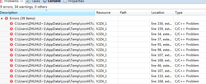

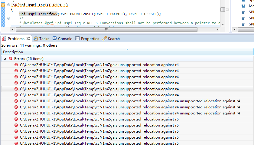

I used S32 studio  to build mcal files(MCU type: MPC5744).
When I executed the "build" command. There are many errors in "problem" window.
1. ccN1mZga.s files is not existed.
2. "Temp" folder is not source path, so the compiler shouldn't compile this folder.
so , how can I solve this problem? Thanks.

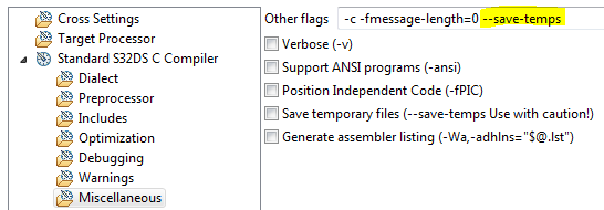

You see S files in temp folder because they are generated on intermediate step during compilation of your C files.
You can add --save-temps option
and see all of them in your build folder.
After that you will find out following:
Finally you will see invalid inline assembler syntax in EXIT_INTERRUPT().

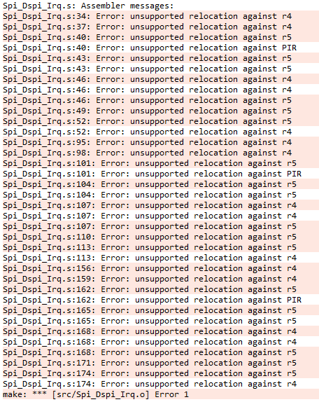

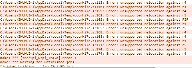

In the problem window, the information is shown below:
In the console window, the information is like:
I add the source code and manual of compile parameters in the attachment. Could you compile those code in your environment? Help me to figure out the problem.Thanks.
