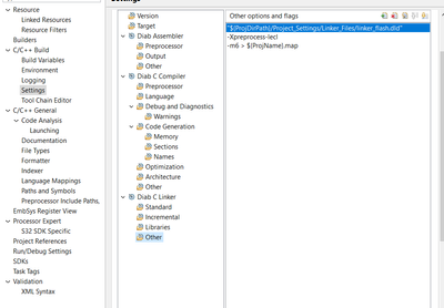

I tried to compile a project with diab compiler installed in S32, and wanted to generate PTP binary format other than elf default output.
How can I configure S32 and set up compiler option to make this happen?

Nxp_2022
Thanks Lukas,
As my project is working with installed diab compiler, there is no option about flash image available under "C/C++ build -> Settings", I also looked over the others, but didn't find any binary output setting. I am wondering should I need to do anything in "Diab C Linker" section under Other tab in following screen shot, and what kind of option has to be applied?
-Jim

Hi Jim,
ok, I have never had Diab plugin installed... @jiri_kral would you know if Diab support this?
