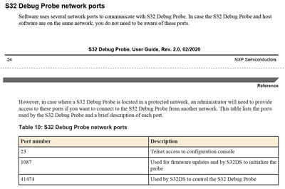

HI
customer ask if below listed ports (used by S32 debug probe) can be changed ?
thanks
best regards
Jochen

Hi, @jochengerster ,
Sorry, for delayed response,
in the document Port 41474 is typo, it should be 41475. first two mentioned ports, i.e. 23 and 1087 can not be changed

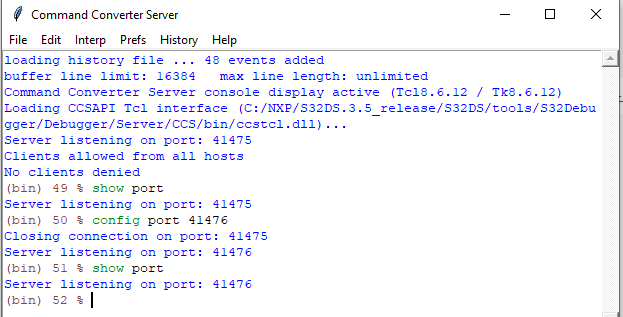

The port 41475 is used by CCS (low level debug application). CCS is mentioned in the user guide. This port can be changed in CCS as below:
Please can you ask the customer what exactly the requirement, or more information why he/she wants to change the port number?
I have also attached the updated user guide, Please find the attached and you can forward to the customer.

jochengerster
Customer had problem due to IT security settings blocking the access - maybe the typo already was the problem that he requested to open the wrong port.
Good to know that the control port can be changed
thanks for your help

Mehul_Patel_NXP
