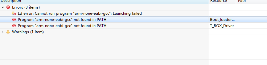

yeah ,I have a default output settings.and I donnot know how ,I compile today,there are three errors show up,like the below....pastedImage_2.png

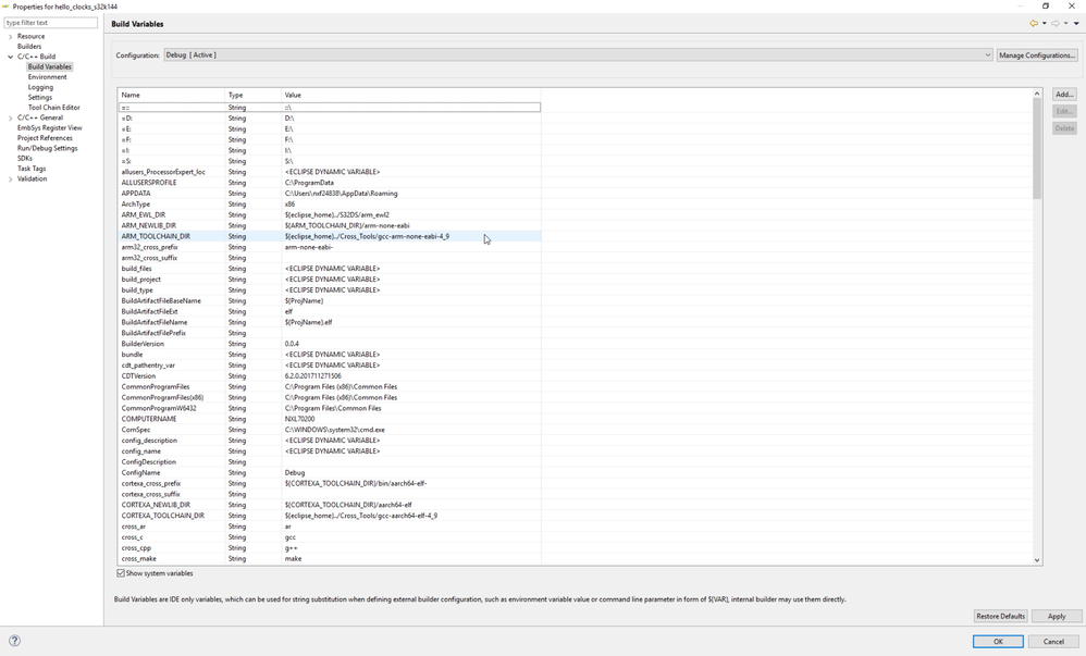

Check if your ARM_TOOLCHAIN_DIR points where arm_none_eabi_gcc.exe is physically located on your hard drive:

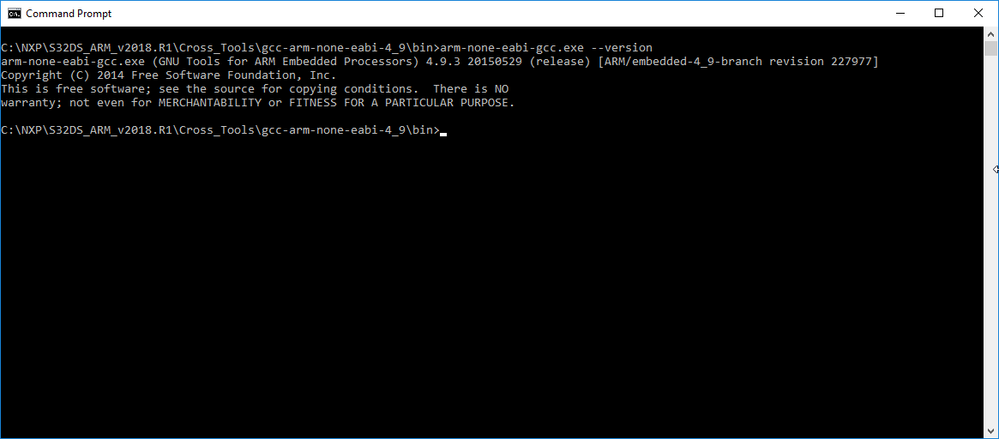

And also try in console if the file is executable (you may be facing some encryption issues):
Jiri

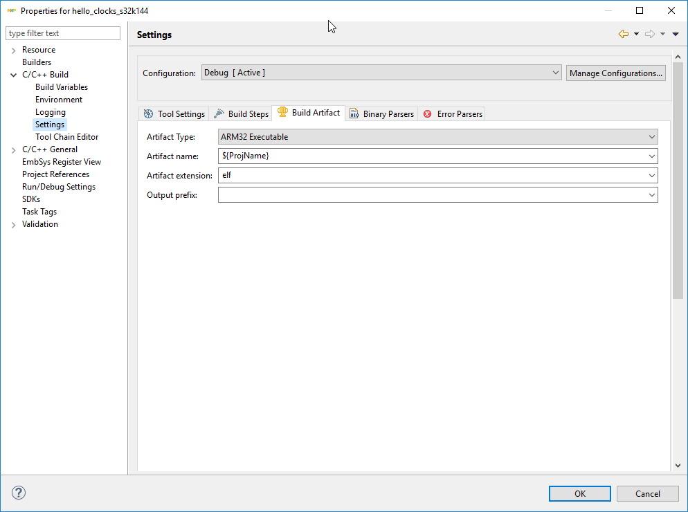

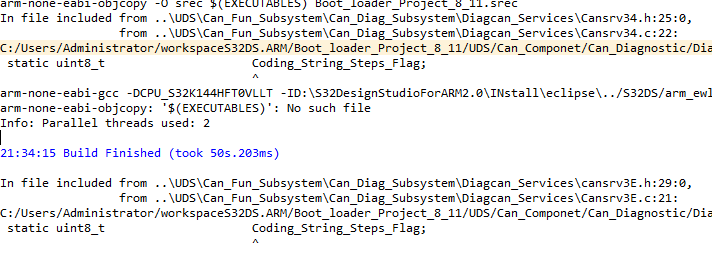

If you remove creating .srec file, are you able get .elf file? From the output it looks like that the .elf is missing as a .srec source. Any other error messages in console?
Do you have default output settings like on this screenshot (in project properties):
Jiri

jiri_kral
can you please show output from build console?
