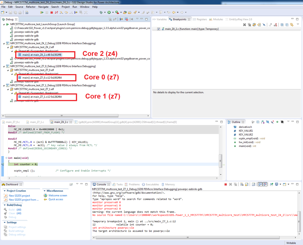

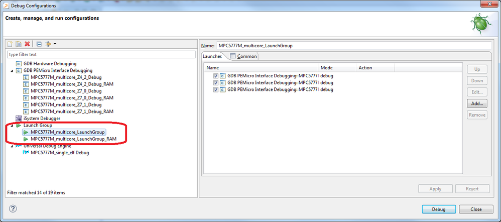

In order to debug multicore project you have to run a launch group configuration:
When you press "Debug" button it starts programming flash and loading all information for the cores. At the end of loading process (which might take several minutes) you should see something like this:
Now If you click on a specific thread in Debug View you switch the debug context/core.

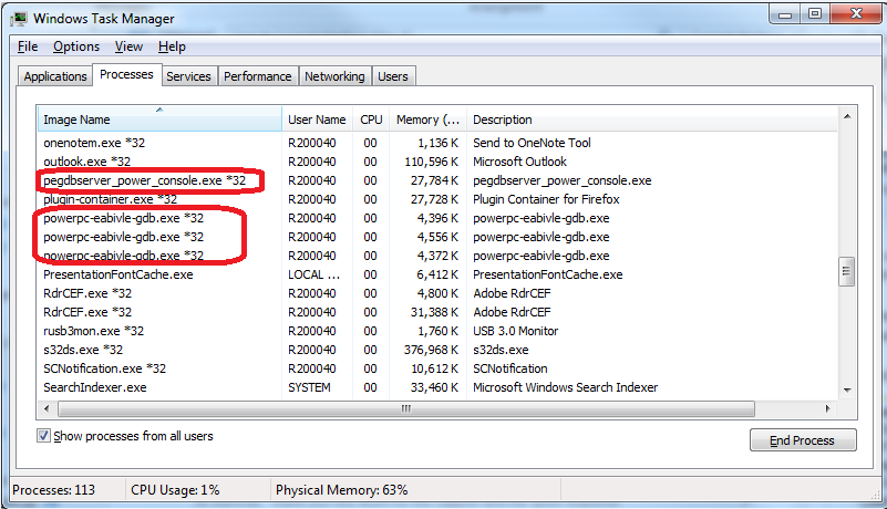

3) check if there is a running instance of debugger server/client service. If so please terminate it first(Click on "End Process").
