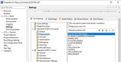

There is an option under:
In which the defines are provided. Also, there is a section under the "Help Contents" on regards of setting environment variables:

Hi @Daniel-Aguirre , Thanks for the feedback. Below options are fine when using in IDE. we want to pass an extra argument during Headless mode while launching.
For e.g;
build.bat (which defines the variant e.g., ProductVariant1) --> Launch S32DS and access ProductVarinat1 in terms of preprocessor directives.

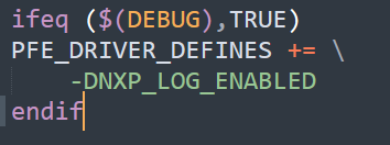

Also, an idea came to our mind, can you modify the makefile that is used for building the project? Something like shown below:
Where you could modify your makefile prior to building the project, and maybe with the use of flags some defines are added to the build.
Again, we apologize for the delay on this topic.
