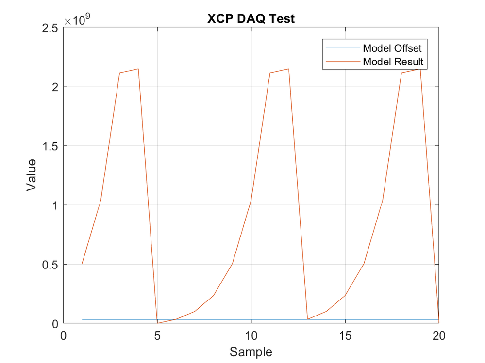

I have managed to implement the XCP Driver (with linker suppression of multiple definitions) and DAQ mode is working, to an extent. I was able to connect to the MPC5744P-DEVKIT using MATLAB as XCP Master, however, the data is wrongly scaled. For testing, a basic model is implemented:
uint32_t model(uint32_t res) {
    if (res < 2000)
        return res * 2 + modelOffset; // modelOffset set to 2.
    else
        return 0;
This model is once each iteration in the main while(1) loop. However, on reading the results in MATLAB via XCP, the data range is scaled:
I provide the code as well as the MATLAB script used to talk to the DEVKIT. The A2L file was generated using Vector CANape 15.
17,658 Views

I'm afraid that this question is out of scope for this community subspace. You can try ask on https://community.nxp.com/community/mbdt
Anyway - it may be caused by big-endian architecture of PowerPC (you are using multi byte numbers). But it is just guess.
Jiri

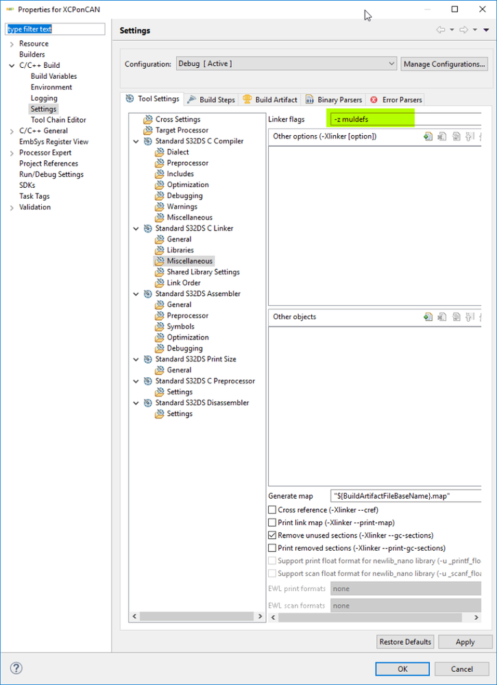

jiri_kral
you have bunch of multiple definitions in your project (I didn't look for reason).  With -z multdefs linker option your project can be build, but I didn't test the functionality:
Hope it helps.
Jiri
23,664 Views
chuluezhong
Thanks for this. The linker command -z muldefs does indeed remedy the problem.
I have tried surrounding all my definitions with #ifndef ... #endif guards without the band-aid linker command and the above error still appears suggesting that multiple definitions are to be found within the supplied XCP driver code.
