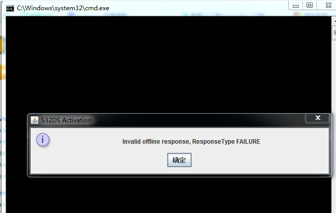

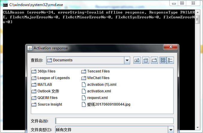

Hello
  i am installing the S32 ds for power V1.2,when i use offline activation,the problems encountered are as followspastedImage_2.png
I've tried this method,but it didn't work.S32 Design Studio Offline activation issue hot fix

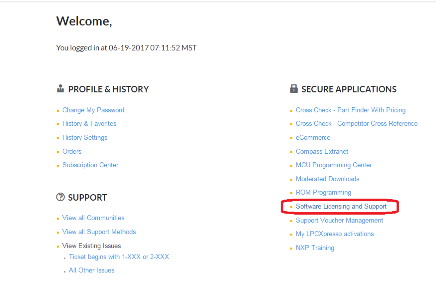

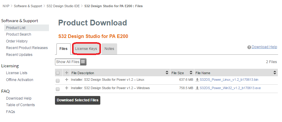

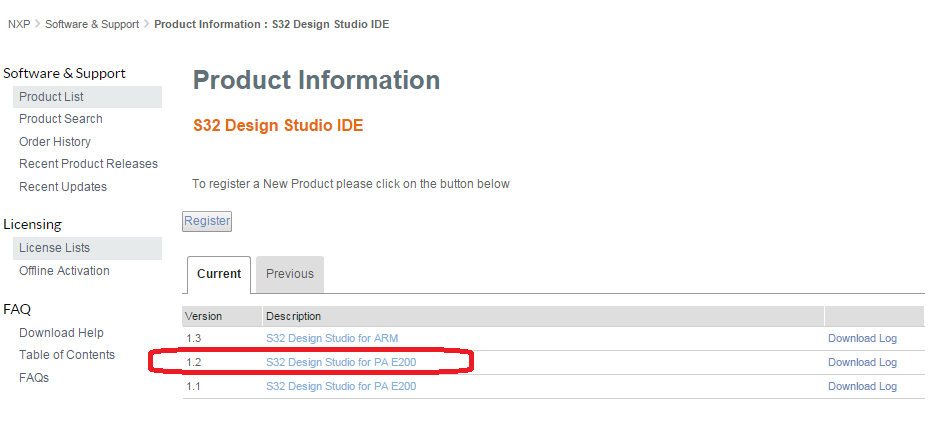

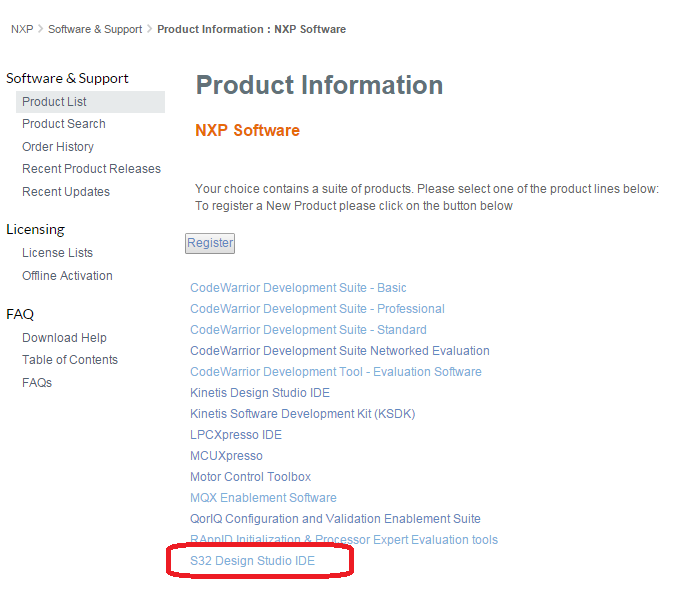

I suspect you are using an Activation ID from previous version of S32DS for Power v1.1.
New version of S32DS for Power v1.2 requires a different activation ID.
You should receive a notification email that includes the new Activation ID after  you click on download link and proceed to downloading.
Please try to search for this email. As an alternative you can go to your nxp.com account and list the nxp software you have. Under S32 Design Studio you should see v1.2 available.
If you click on it you get to the files and license keys section where you can retrieve your Activation ID:
Hope it helps!
