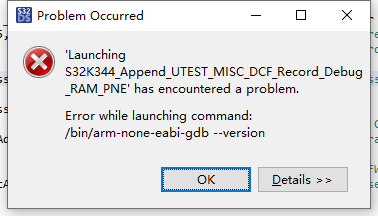

Hello, using PE for debugging download, what is the reason for this problem
3,974 Views
chuanlin
Just change the workspace. Thank you。

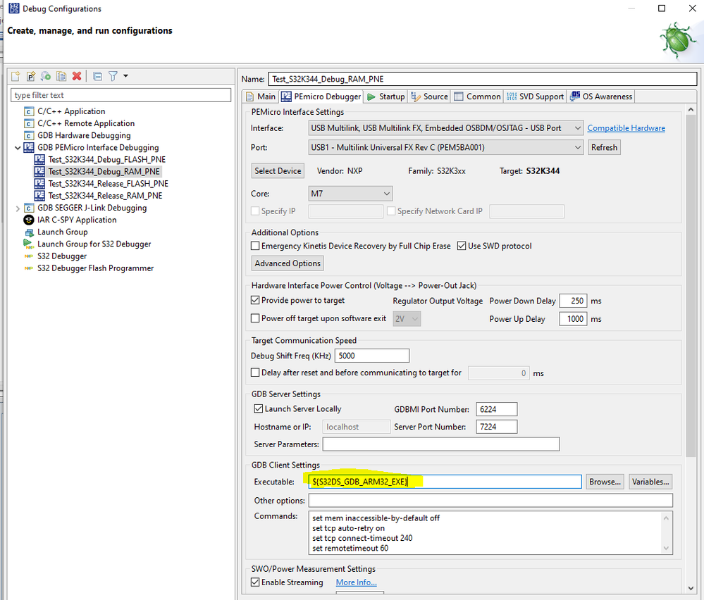

The error seems to indicate that S32DS3.5 is not able to find the gdb client. (Or probably missing command gdb launch in debug configuration.) The gdb client is specified in the debug configuration. Please check that the default setting is as below:
Please can you check and get back.
