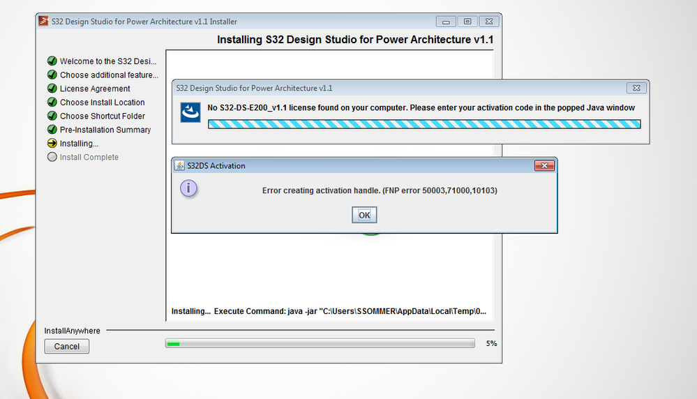

I've got Problems installing the S32 Design Studio IDE.
If I run the installer as admin it collects all data needed for the Installation, but aborts directly after with the errormessage "multiple instances of the installer not allowed. Exiting". If I run the installer as a regular user I get asked for admin-rights at the product-activation. When I enter my product-ID another error comes up (online as well as offline activation, screenshot below).

Solved the Problem after looking at the install logs. Seems like the installer doesn't ask for admin-rights when it tries to install the unistaller.
Worked fine after logging in as admin on my machine.
