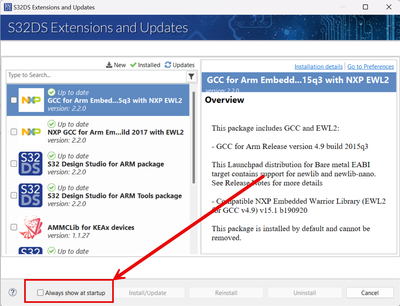

Is S32 Design Studio for ARM v 2.2 still maintained? When I launch it or click on 'Help -> S32 DS Extensions and Updates' it pops up a window saying 'operation in progress' and just hangs (until I click 'Cancel' to close the window).

Thank you for your interest in our products and for contributing to our community.
S32 Design Studio for ARM v 2.2 is no longer maintained, instead of that, we recommend use newer version of S32 Design Studio for S32 Platform with newer version of RTD for the device you are using.
What you can do is go to Help -> S32 DS Extensions and Updates and uncheck the following box:
It will take a while to open the first time, but on the next launch it will not open automatically.
I hope this information is helpful.

Thank you for the suggestion and also solving the mystery of 'why it is hanging'. I do agree with you that the only way out is forward.
