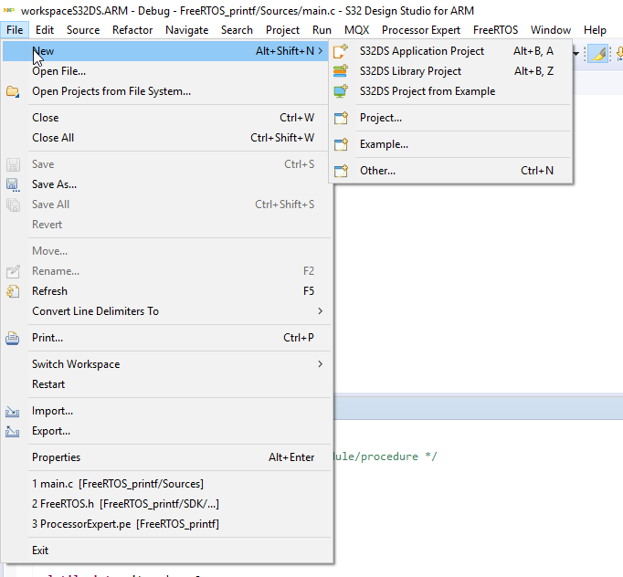

in my S32 Design Studio 2.0 for ARM the "New S32DS Project" option is missing. Only the "New S32DS Project from Example" is available.

Hi Jochen,
there is probably something wrong with installation itself. In my S32DS Arm 2.0 the New menu looks like this:
For new empty project is "S32DS application project" option.
Here is about screen of my S32DS:
So - you can try to re-install S32DS or try if at least keyboard shortcut works - ALT+B, A
