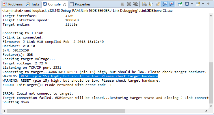

I am new to S32 Design Studio.  I have a build a "Hello World" demo project and now I am trying to debug it using j-link. I have checked the JTAG that whether the is connected properly or not. To my best of knowledge everything is looking fine. But when I debug it, this happens.
Please, guide me what I am doing wrong here. Because the ribbon is properly connected with with both the debugger and S32-k148 board.

According to the log you posted it seems the Target voltage is not sufficient.
How do you power the board? (USB cable  vs. external power supply)
I'd recommend you to check if the board jumper settings matches with your setup.
https://www.nxp.com/docs/en/quick-reference-guide/S32K148EVB-QSG.pdf
