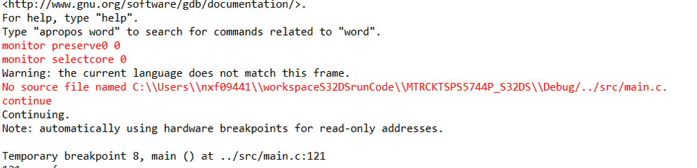

Hello, I am developing the MPC4744P in the S32 Design Studio Vision 1.2, Beause the software project is created by other engineer, I just debug it.  I found the single step debugging have issue on the debug mode , and report the error. please see the below printscreen. The path \\nxf09441\\workspaseS32 is not in my computer. It looks like engineer's computer path that creat project. How to fix the issue? Thank you.

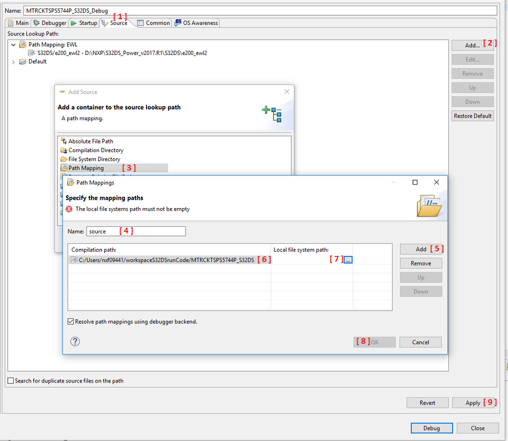

Path mapping is your friend. See Source tab in debug configuration settings.
