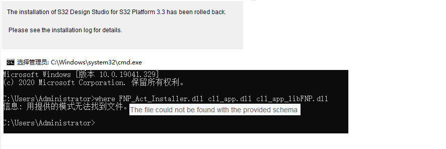

Fitz-Huang
Hi Stan,
I met the same issue when I install S32 Design Studio for S32 Platform 3.3,but I cannot find any .DDL file in my computer, please help me to fix this issue
thanks

小娟胡
Hi Stan, I met the same issue when I install S32 design Studio V1.3, but I cannot find Teradyne SSL and LDRA_Toolsuite in my computer, please help me to fix this issue
thanks
