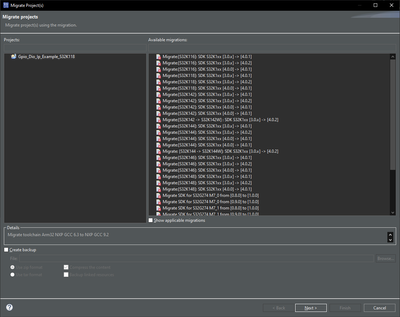

VaneB
Hi @durga_choudhury
As you mentioned, S32SDK S32K1XX RTM 4.0.2 is only compatible with S32DS 3.4, so it will not be possible to use it with S32DS 3.6. Regarding FreeMaster, it is a tool, not software. The best option is PlatformSDK_S32K1_S32M24 v3.0.0 (S32K1_S32M24X Real Time Drivers AUTOSAR R21-11 Version 3.0.0), which is the most recent software release for the S32K1 family and is fully compatible with S32DS 3.6. Therefore, I recommend this option according to the IDE version you are using.
As you can see in the following image, there is no available option to migrate from an SDK to an RTD. If you want to use the migration feature, as I previously mentioned, I recommend using S32DS v3.4 with S32SDK S32K1XX RTM 4.0.2 or 4.0.3 for this.
