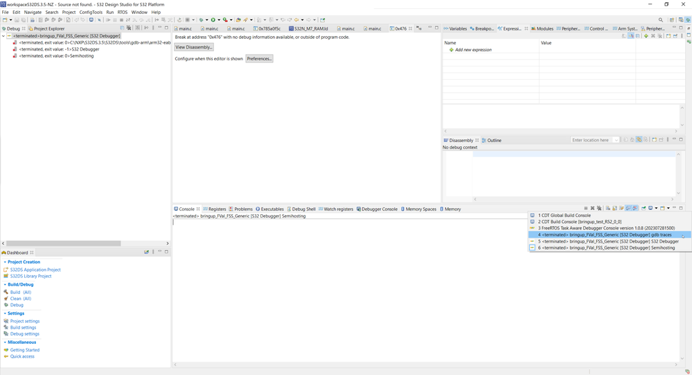

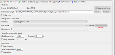

Hello team,
           I am working on the customer project in S32Z27X Soc. When trying to do ddr training it says that Serial parameter error. So First I thought I would do the example binary flashing in SRAM using the S32 debug probe but when I tried to flash it hangs at 52%.
I can able to read the board details but can't flash,
Could you please help me to solve this issue?Flashing Hangs..pngFlashing Hangs..pngBoard_Status.JPGBoard_Status.JPG

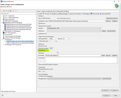

Hi, @Enoch07 ,
Please can you provide GDB log, instead of the log for DDR.
Frist you would need to enable the GDB trace using enabling the GDB trace from the properties:
You can view the log as from the Gdb traces options as below :
Please can you attach the GDB trace and we will follow-up with you for the issue.
Thank you. Best regards.

Enoch07
Hi Patel,
       I have enabled the GDB trace in my Design studio. And I tried to flash the RTD example on my board. But it hangs at 52% and I can't able to see any GDB trace window. Here I have attached the screen short of my S32 DS.

I have tried to flash NXP example RTD's also but same issue.

Daniel-Aguirre
Thanks for your feedback.
Under our setup, we are not seeing the same results as yours:

Since you cannot load an example from the RTD, we suspect that it might related to the switches configuration.
But again, our setup is using an S32G2 chip. Since this seems to be related to S32Z chip, help us contacting your local NXP FAE.
Please, let us know.

Can you please also get the S32 Debug probe log? It can be enabled in debug session configurations:
29,938 Views
Enoch07
Hi, I enabled it as per your suggestion, but I can't see the s32 debug probe log.
29,910 Views
Daniel-Aguirre
Once enabled, under the console, you should see the different reads and writes that the debug probe is doing. Are you not able to see this?
We can also recommend opening a ticket on this regard, if confidentiality is required. We also understand that an NXP FAE is working with you, is this correct?
29,893 Views
Enoch07
Hi, I can't able to see anything under console.
Yes FAE is working on this also.
thanks & regards,
Albin Raj R J

Daniel-Aguirre
We are seeing the following message on your S32DS:
We understand that this message explains that S32DS is still trying to load the RTD. Can you verify if after S32DS loads the SDK the problem persists?
Also, can you verify if the "Test connection" provides any information on regards of the debug link:
