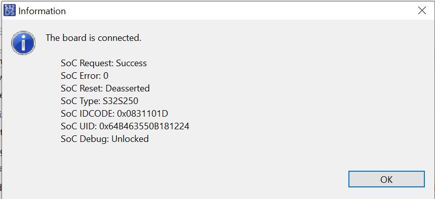

Hello team,
           I am working on the customer project in S32Z27X Soc. When trying to do ddr training it says that Serial parameter error. So First I thought I would do the example binary flashing in SRAM using the S32 debug probe but when I tried to flash it hangs at 52%.
I can able to read the board details but can't flash,
Could you please help me to solve this issue?Flashing Hangs..pngBoard_Status.JPG
thanks & regards,
Albin Raj R J

31,317 Views
Enoch07
Thanks for the response. When I tried DDR training board was in debug mode.
So I tried to flash the RAM using an s32 probe.
 But it struck in 52%.
is there any chance that because of S32 debug probe issue?

31,291 Views
Enoch07
Yes, Already Board is in Debug mode,
Below is the log of DDR training and it hangs here almost 2 hour:

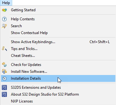

Daniel-Aguirre
Thanks for the feedback, can you share with us your "Installation Details" output?
For us to understand what the problem might be. Since we cannot reproduce your output, we might be able to reproduce your setup.
Have you confirmed that there is indeed an S32G274 below the heatsink of your EVB?

Daniel-Aguirre
We are seeing the following message on your S32DS:
We understand that this message explains that S32DS is still trying to load the RTD. Can you verify if after S32DS loads the SDK the problem persists?
Also, can you verify if the "Test connection" provides any information on regards of the debug link:
